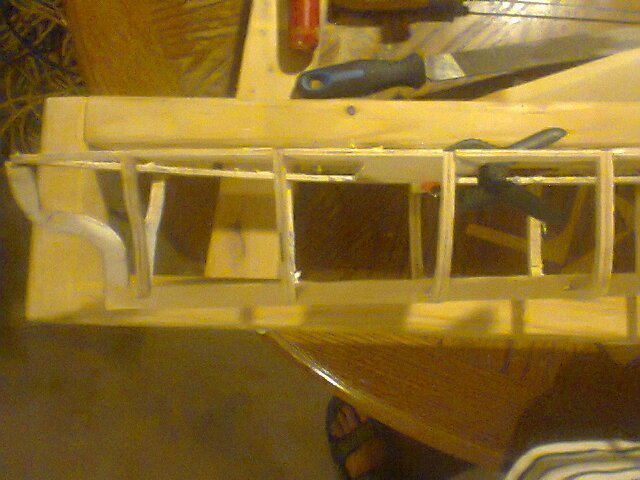

    Update on little lib ive finished cutting out all the frame peices sanded and rought fitted them. hopfully sometime in the next week i will start glueing her together.For the bottom and other impentrable areas i plan to block in with basla then fiber glass. After that im not sure how im going to procced. Still have not found a 1/32 sheeting material. also need to figure out which rule set im going to build to soon. i know its going to be for fast guns.
    Cant remeber how to add images to post.
    ps if anyone has any tips about liberty ship builds can u let me know.

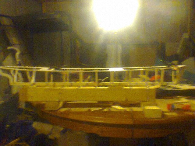

    side view.
  4. NickMyers
    This looks like its coming along nicely. It looks like you're making your subdeck out of 1/8" ply? If so, you're probably going to want to add some material there to strengthen that a bit. (Typical builds use 1/4" and then the 1/8" deck on top of that).

    where should I put the extra strips? is it to keep the shape or for keeping the top deck in place.
    What I was thinking of doing was to put 1/4 inch ply piece over the three holes to cover from side to side.
    Thanks for the advice.
  6. Beaver
    What Nick was saying, was to glue extra strips of 1/8" ply wood to the bottom of the 1/8" sub-deck to make it 1/4".
    Mike Mangus did this on his Bearn thread, page two to be exact: http://rcnavalcombat.com/Forum/tabid/58/aff/566/aft/407920/afv/topic/afnp/480576/Default.aspx

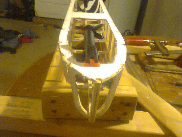

    Ok so quick update. Ive gotten most of the bottom pieces of balsa in and rough sanded the nose too. Not to sure about the last two section how to do it? see the second picture. next things to do are the prop, drive shaft, rudder, motors. not sure about these areas. found some info about prop and rudder. dont have a clue about drive shaft motor, and other electronics.
    Side note found out today that my school has a nice workshop that i should be aloud to use.:):)
