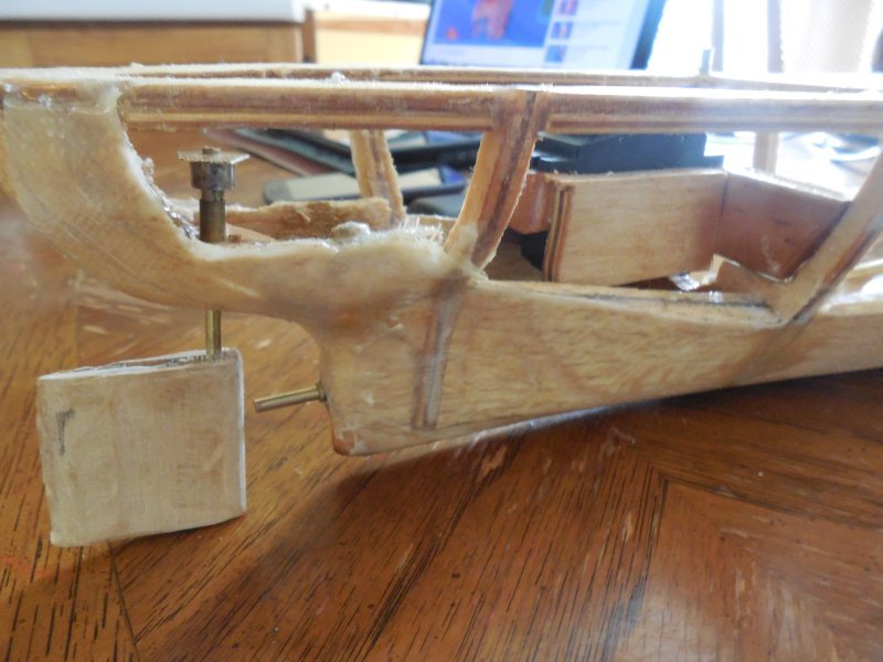

    Hey got some more work done this past week.

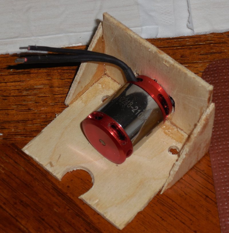

    Build and installed mount for my servo, should have everything ready for steering.
    As for motor, tried to build a motor mount out of old metal bracket. didnt work. so trying again out of extra plywood.
    Any cheap ideas for water tight box for reciver.
  10. Beaver
    Looks good! Don't forget to drill some small holes in the wooden mount so you can put in screws to secure the servo, otherwise the torque from the rudder will pull the servo out.
    Instead of having a watertight box (WB), you could just pot the receiver in E6000 adhesive. Two or three layers of E6000 will do, just don't get any glue on the pins. Best to put masking tape over them. (any tape will do)
    Too bad the metal mount didn't work. They can be tricky, but are nice when built. I built one for my cruiser out of angled aluminum. If you're interested, here is the process I used.
    1. Drill a hole in the center of the mount. (hole diameter is dependent on the motor requirements)
    2. Draw two lines on either side of the hole straight up the top of the mount.
    3. Cut the lines with a hacksaw.
    4. Measure how far from the center the screw holes need to be. (might be easier before you drill out the center)
    5. Drill holes at those two marks with a drill bit smaller than the head of the mounting screws.
    6. Repeat steps 2&3 to the holes.
    Now you have an adjustable motor mount that will last a millennium. There are photos of this type of mount in my Suffren build. (page 14)
    Good luck. :)

    Going to drill the holes tomorrow, hopefully. I read most of 34 pages your suffren build thread last night,nice work. Also made a new motor mount im happy with it even if its overly big. pic tomorrow maybe. lol.

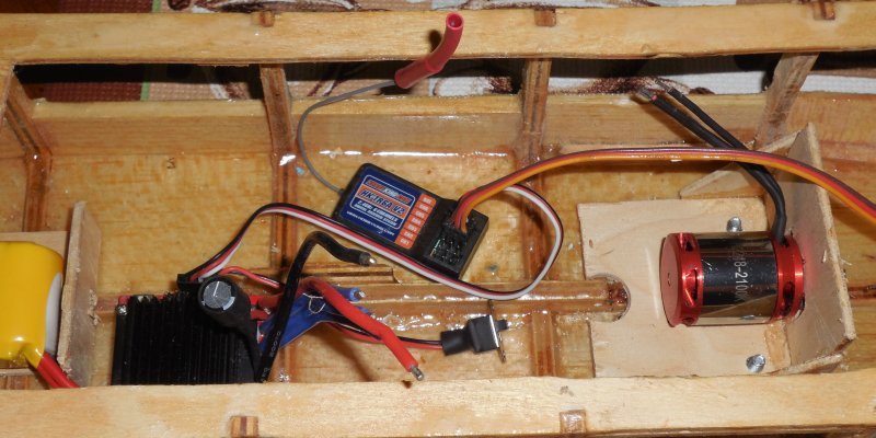

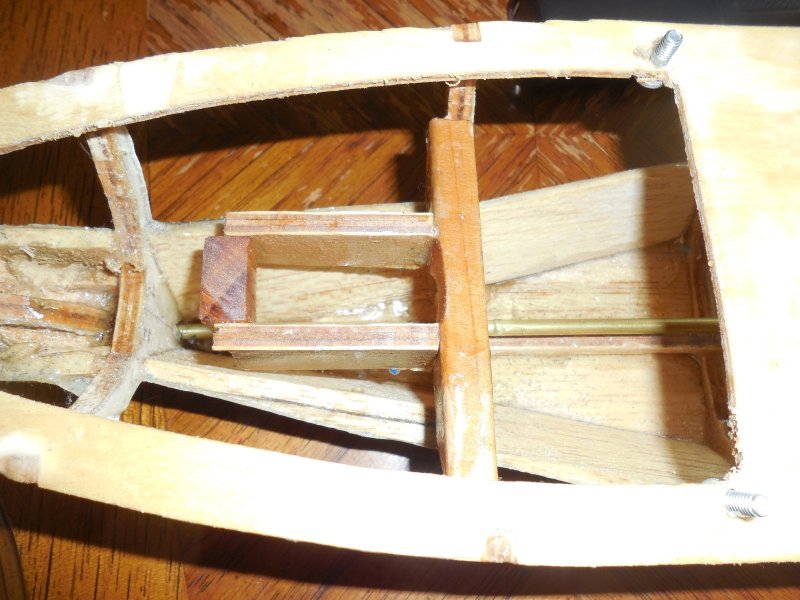

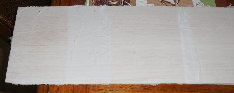

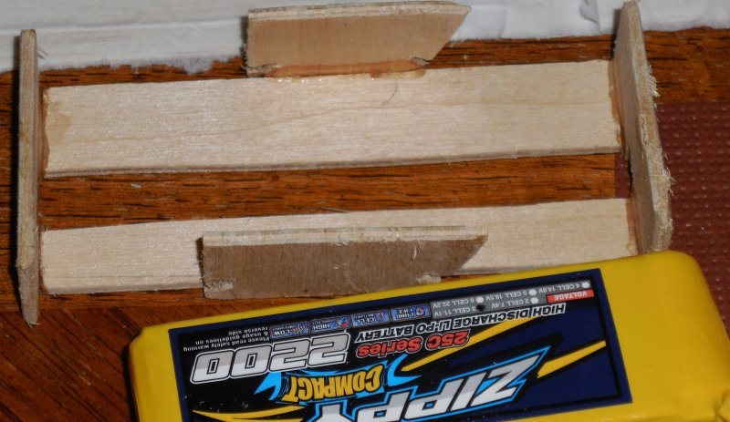

    Hello everybody hope you enjoyed the long weekend. Over the weekend I've gotten a bit of work done.
    I have a question about sheeting process, in not sure if i need to use lacquer/ varnish to seal the balsa wood, and what is the best way to attach the sheeting to the ship.
    Sheeting with tissue paper.
    Plus I ve gotten my motor mount and battery holder complete.
    [​IMG][​IMG][​IMG]
    Last but not least. my plan for how everything should be arranged[​IMG]

    I think you want to seal the balsa with something, what may vary by rule set, but I'm not sure. Seems like I have read some rules that limit the amount of silkspan, and the type and amount of coatings. I used Nitrate dope to seal my balsa.
