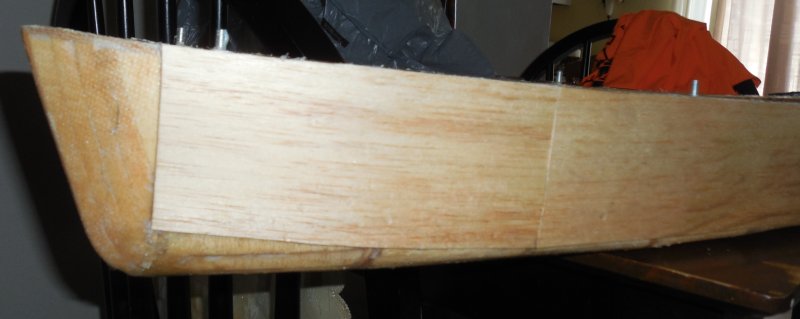

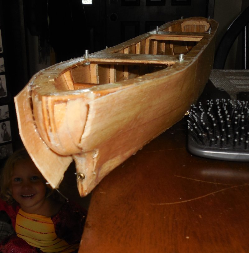

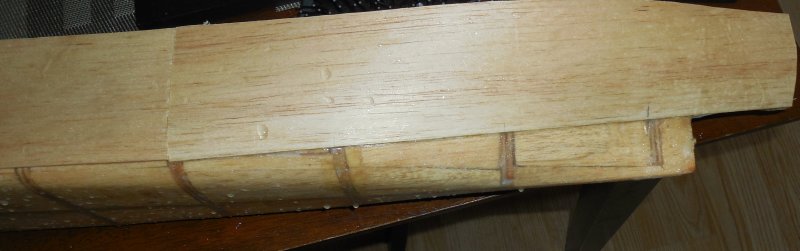

    Hello It's me again. Just uploading some pic of the sheeting.
    Front
    Back
    Now here is the problem area
    My solution is to cut to the next rib, clean that area as best as i can. Without damaging the balsa wood. And try reattaching new siding.;)
    I hope it works.

    It looks real good aside from the problem area you pointed out, which isn't terrible... I would try to find a way to get the current sheeting to stick and only cut away and reapply as a very last resort. You may have a bit of a difficult time getting the sheeting on nice if you only have one rib and the stern to adhere to. Did you seal the inside of the balsa and water proof the ribs and hull before you applied the contact cement? Mine looked very similar to yours while I was trying to sheet it. I spent around 2 hours applying pressure and re sticking it down until the contact cement had cured enough to hold it. Maybe I didn't quite do it right myself. I'm wondering if you could just brush some more cement between the 2 pieces as it sits, let it dry good and then try to re stick it down?

    I got it fixed last night, had to remove the sheet two ribs back as Cannnonman suggested, as a last resort. Was possible tired because my first attempted, I set the pieces upside down. Yea I was pissed after being happy how everything was going. That being said, I did a quick leak test and failed it. My question is what the best/easy way to fix these leaks. The glues i have are contact cement, E6000, varnish, and west system epoxy for fibreglassing.

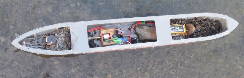

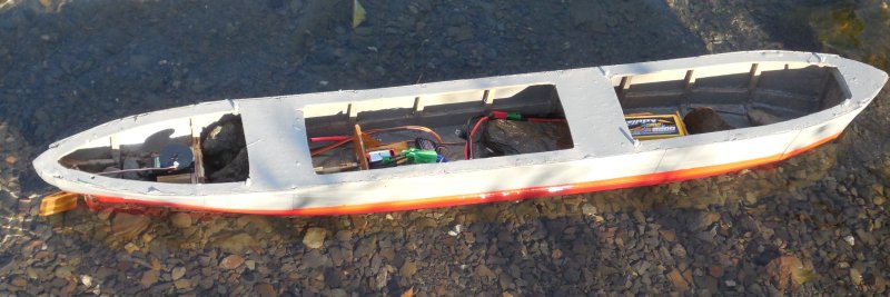

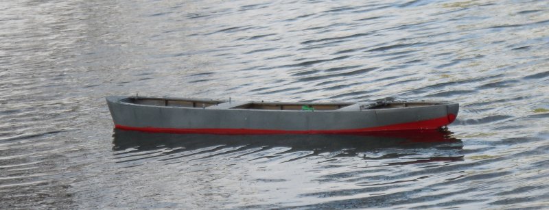

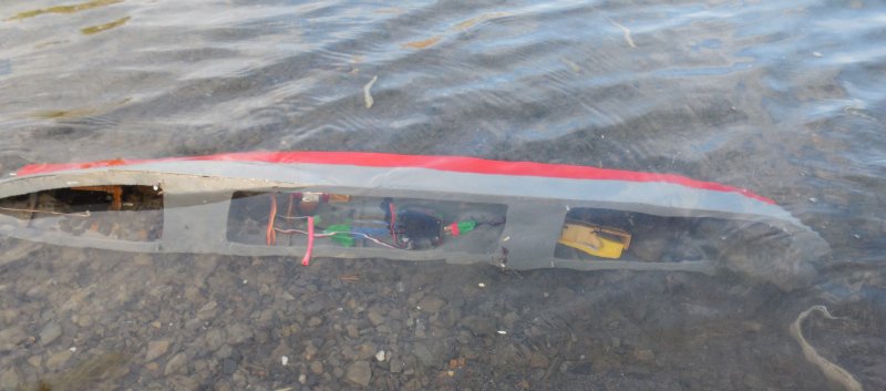

    Hey I got lib in the water and got her moving about.
    Lib first few moments in the water.
    She is way to light so i add some wieght.
    She truly is a transport ship. but she close to her water line messed up the water line on stern on one side.
    And of course her maiden dip.
