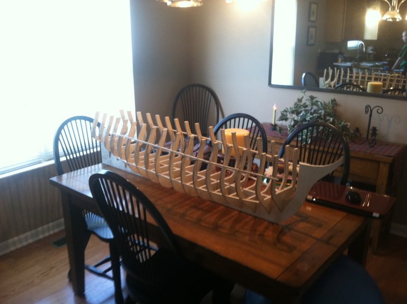

    I decided to jump on building an Age of Sail warship. I had hoped to build one of the American 74s but wasnt able to find suitable plans. I did however find plans suitable to build the USS Pennsylvania. I am hoping to have this ship on the water sometime this fall prior to the battling season ending.[​IMG]

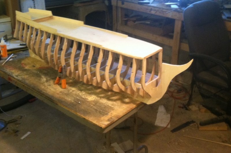

    RE: USS Pennsylvania Thanks Mike, Today I made a sub deck/deck that I placed on top of the ribs with the goal to have the entire Spar(?)(Weather?) deck removable in one piece, with smaller access hatches within the deck itself. I picked the Pennsylvania for its relatively simple hull shape. I am also trying to fashion a type of socket or reciprocal for the masts to rest inside, being secured with screws to allow them to be removed. I had some questions for the AOS community.

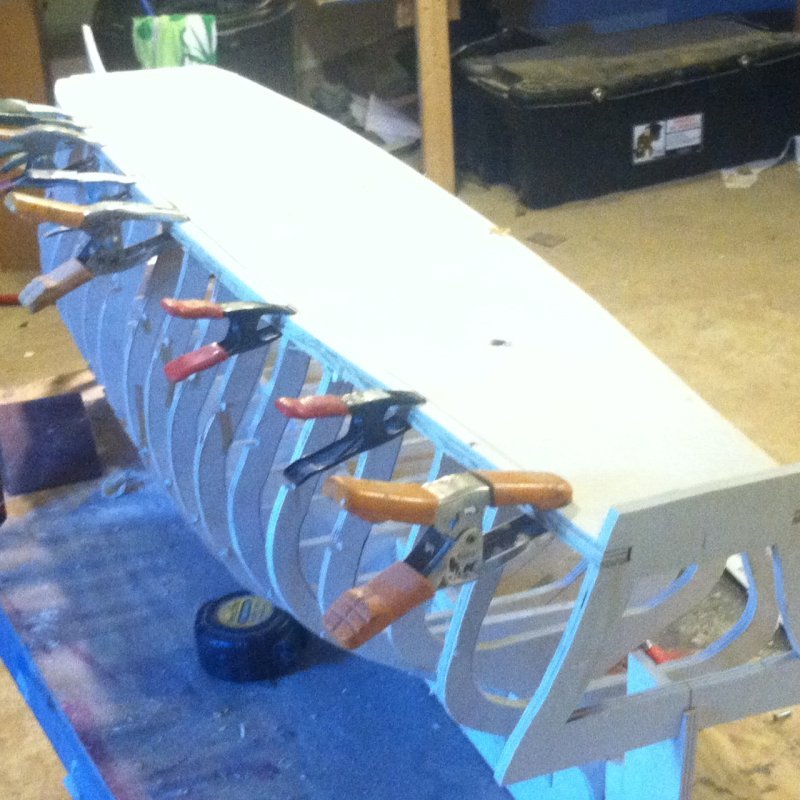

    Sadly through a mistake saving some plans to the laptop I managed to over write L'Ocean class ribs over the Pennsylvania Ribs, Found out when I tried fitting my deck to the hull. Is there a way for somone to change the name of this posting to French 118 gun?

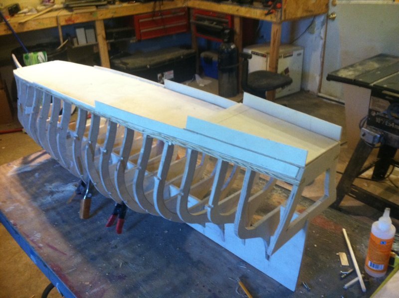

    RE: USS Pennsylvania I have worked on the gun walls around the Forecastle, and the railing over the top edge of the upper most levels of the gunwalls. I had to move my stringers up 1/2" to fullfill the proper amount of penetrable area. I drilled out the holes for the three masts with deck breaks at each mast. The stern Galleys? has been started that attaches to the stern of the ship. The bow hard area is being reworked to resemble the Ocean class 1st rates as built.

    RE: USS Pennsylvania Once the wood I ordered from Balsa usa comes in I will cover the upper impenetrable area, I am going to drill out all the gun ports and use a file to shape them square. I am wrapping the upper hull with 1/32" Aircraft ply, and reinforcing the inner and outer surfaces with fiberglass cloth and resin. The lower impenetrable area I am planning on filling with block and sanding to shape still.
