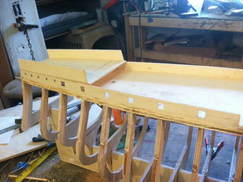

    I decided to try and carve out the gun ports on the quarter deck.

  4. jstod
    Do you plan to plank the hull for realism or some other method?
  5. glaizilla
    glaizilla Active Member
    Sep 24, 2010
    375
    I had thought about that, but was concerned where the lower gun deck is just painted gun coverings, I was unsure as to how to make the planking work. Where the moldings are between the gun decks I am planning on placing molding there, which will cover the composite deck/subdeck shown above. The upper gun deck, bellow the Spar/Weather deck will be armed with dummy cannons. I was planning on block fill and sanding the bottom of the hull+glass and cloth, but will probably plank over it with segments of 1/16" and seal the planks. I want to plank the actual decks, and have been contemplating the myriad of colors used. I have some of the art students working on the carvings for the bow spirit. I have purchased some leafing for the stern galleys. I want the hull to be a dark walnut color, with the uppermost sides blue, with red gun walls, and gun hatches? and all the moldings and rails a midnight blue/black color. all the decorations I was thinking would look good silver. I am unsure about bellow the water line, White has been tossed around alot.
    Realism is relative here, as there will be a 6" (or so) high wall of flat balsa in the middle of the ship (top to bottom), which will not look planked at all.

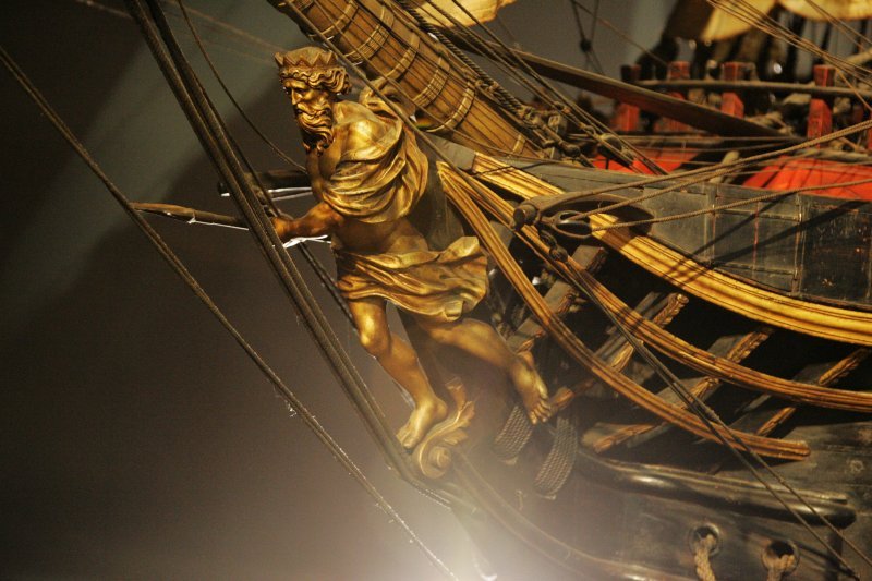

    I have approached the arts department at two of the local universities, and have found a couple students who are attempting to make the bow spirit figure for my ship. I was going to try to either attach it to the ship via magnets, or have use it to make a plug and cast a couple out of resin so if its destroyed I could easily replace it, any thoughts?

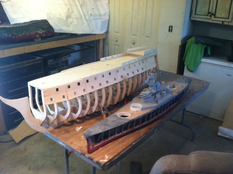

  14. rcengr
    It makes an oversized frigate look small.
  15. Tugboat
    Kinda gives some perspective, non?

    Little work has been accomplished on the Ocean, with the upcoming Denmarck Straits event this weekend, I did want to post a more recent photo, with a ship others are familier with to give a scale of a 1/48 First rate.
  18. Tugboat
    She looks beautiful. I am very excited to see your progress.
