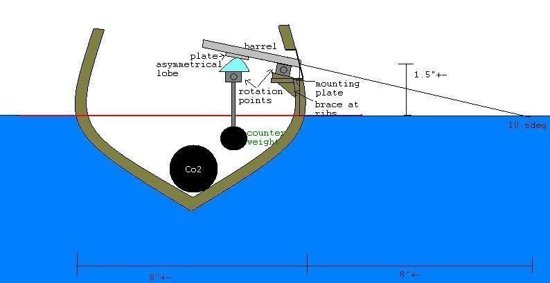

    This was my rough idea. It took 10min or so in paint. I forgot one part though a light extension spring coming up from the bottom to hold the cannons against the lobe. This will help keep the resiliency of tubing and whatnot from affecting gun angle. This would be roughly mirrored on the other side. Placement of counterweight, co2, etc is all flexible. Getting the counterweight toward the centerline would be better. All barrels ride on a common axis and are all linked together so the interaction of lobe and plate affects all of them.

    Looks like it'll work. Though if the ship leans to the left, wouldn't the lobe elevate the cannon?

    It is just a representation. The lobe is completely inaccurate in shape. I didn't feel inclined to do all the geometry and attempt to duplicate it in paint: ) i just know the crucial measurements are the distance between rotation axis and height above axis that lobe contact point is. All that is being done is trying to maintain the angle in the "point" of the triangle.

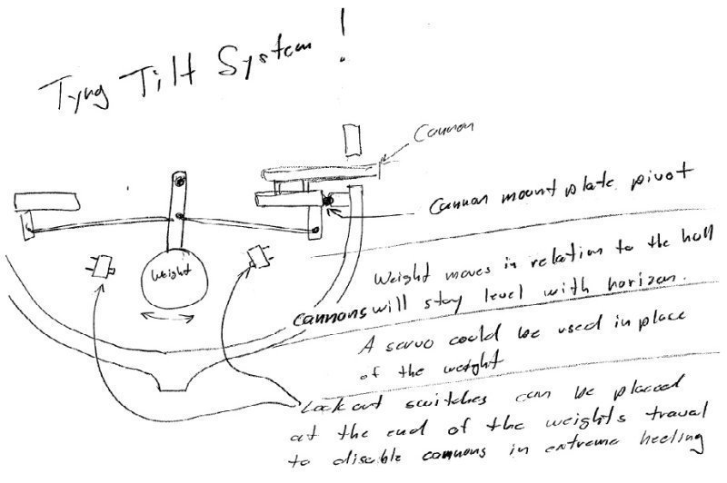

    Another idea.

    That second drawing was how I was thinking of it.
    Das Butts will work just fine as long as the lobe doesn't go past "center" and work opposite as intended, but I'm sure he knows that and I know its a rough quick drawing. I'm just glad people work together here and think outloud. Its more collabrative and makes evolution faster.

    My idea was to maintain the same (close!) range on both sides of the ship regardless of how much it is heeling. That way I can take effective shots even if someone does get the better of me position wise.

    In the TTS concept there are shelves mounted port and starboard attached to the frames via a hinge at each end. These are the cannon mounting plates referenced in the drawing. The shelves are long enough to mount as many cannons as required. All cannon related hardware (guns, accumulators, solenoids, etc) can be mounted to the shelves. Cannons are mounted at any down-angle required on the shelves. When heeling, these shelves stay level with the horizon, thus maintaining any down-angles the cannons are mounted at.
    The lockout switches disable the opposite bank of cannons if the model heels farther than the tilt mechanism can compensate for (i.e. cannons are turned off if they tilt above the horizon).
    In larger models the weight system would work well. In smaller models, a servo and helo gyro may be required due to space limitations (can anyone say Bermuda Sloop ;-).

    I think both would work, but Tyng's would require less space, what with it being just one weight that needs space to swing. It might have to be a weight controlling servo's, as it might require a larger weight to keep the cannons level than you can float with. Adds to the wiring, but cuts down on the lead weights... Infact, a weight on a transmitter stick style potentiometer might work pretty well, and the set up a servo or two to operate the cannon elevation... Could be self-contained, although I'm not too great on system wiring, it might take a bit of custom work...

    I was thinking of using the batteries as the weight. The single weight system has the added advantage that as the weight lifts one deck, the weight of the windward side gun deck pushes down in equal measure. A small rc car shock sans spring may be needed to control the speed of the movement, its going to be an experiment.
