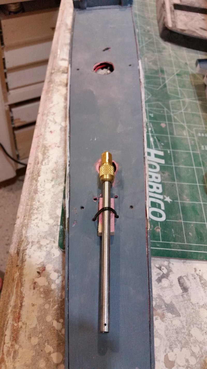

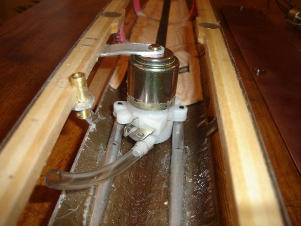

    Will get more pictures of the build, here is the installation of the gun.
    Cut out for the pump top clearing, this will be covered over. The second zip tie has to be added in this photo.

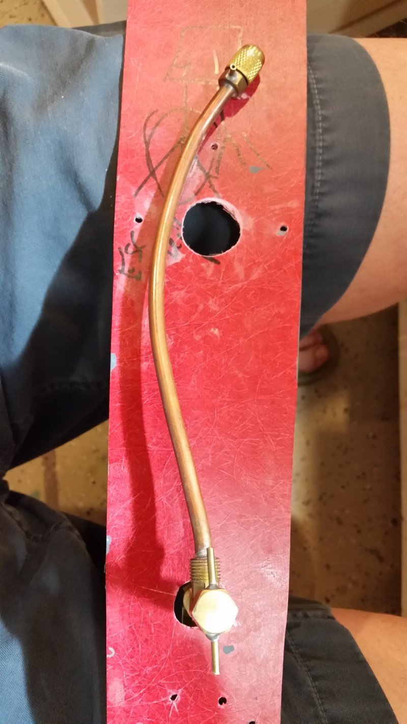

    Old bend on the magazine, too much brass on one side.

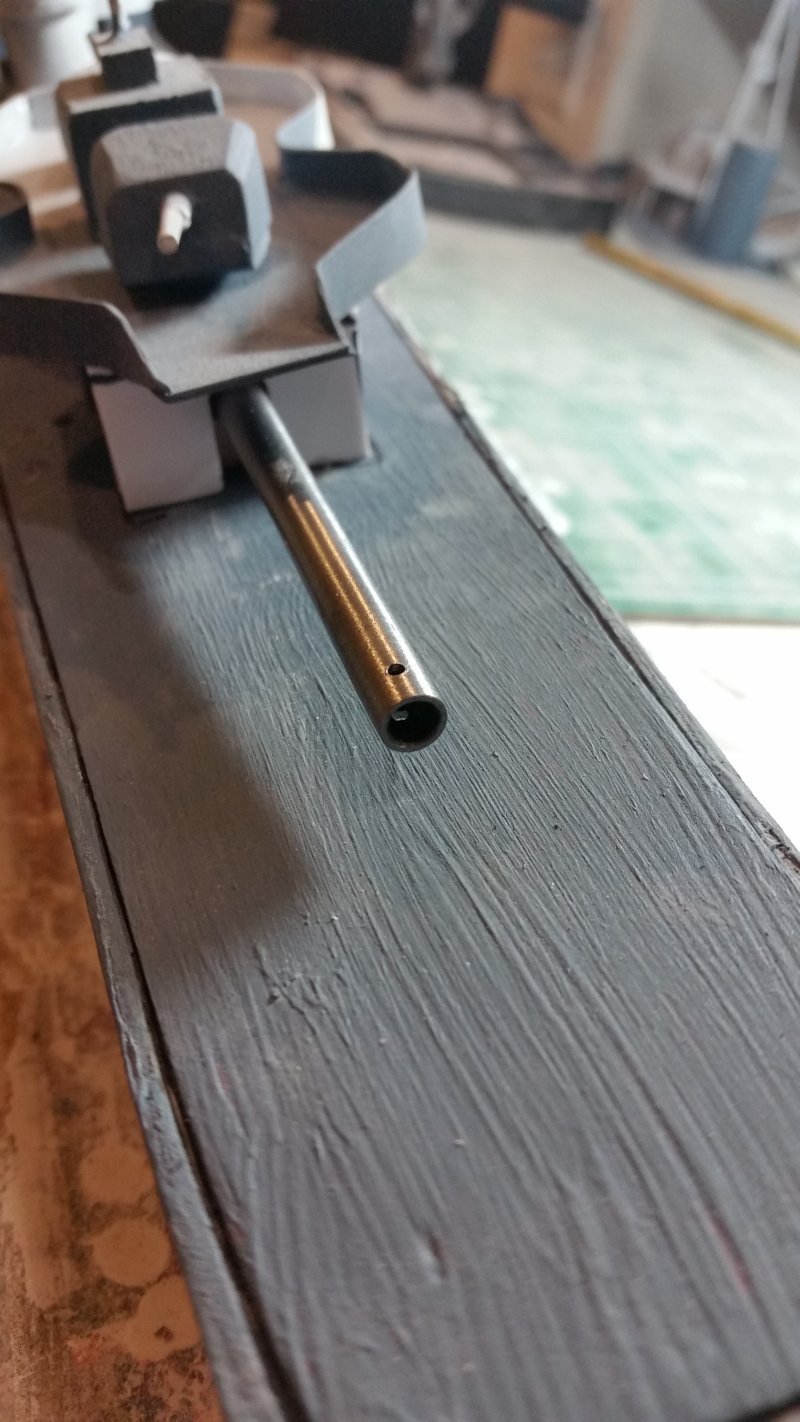

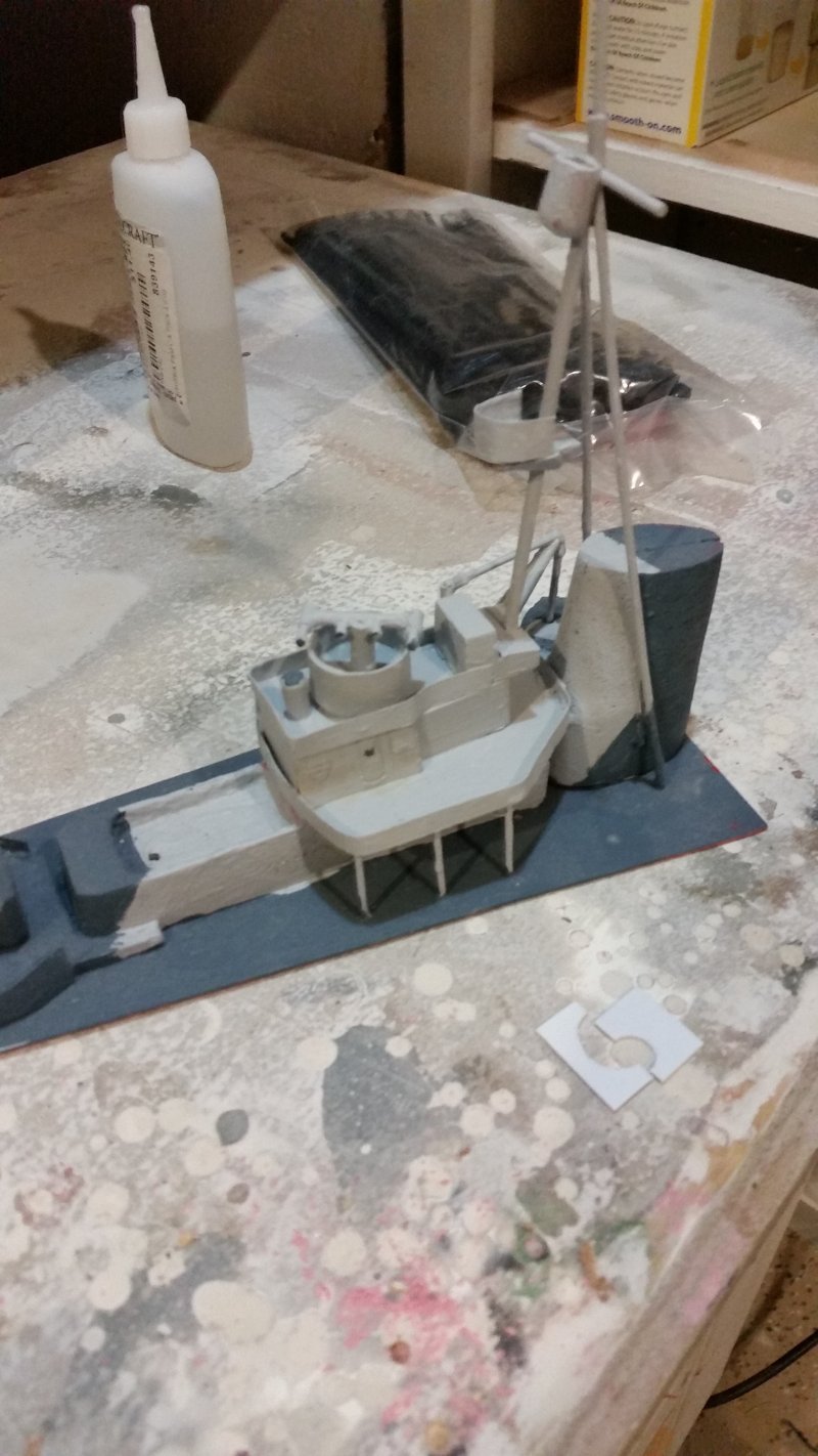

    Made the after superstructure removable, it is held in place with a pin that fits into the deck. The other end will be held in place with the removed gun safety pin. Plastic will be put around the breech to keep out water
    Business end

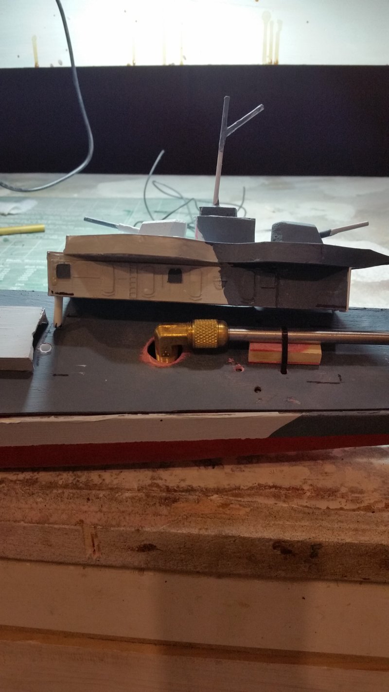

    Worked on getting the pump in place. Outlet is just past the motors and to the side, no room to get it to point to the stern.

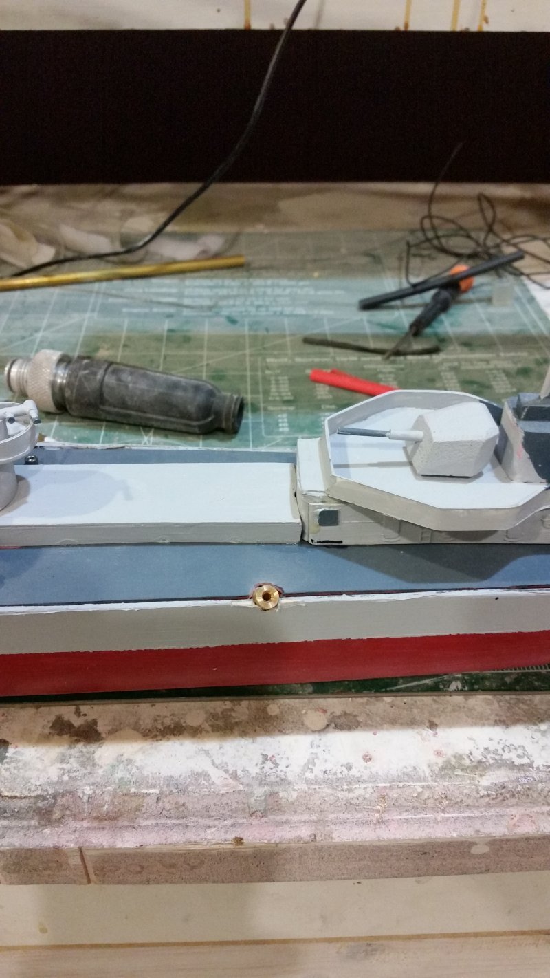

    Forward superstruture comes off in one piece. Easy to access the capsule between sorties.

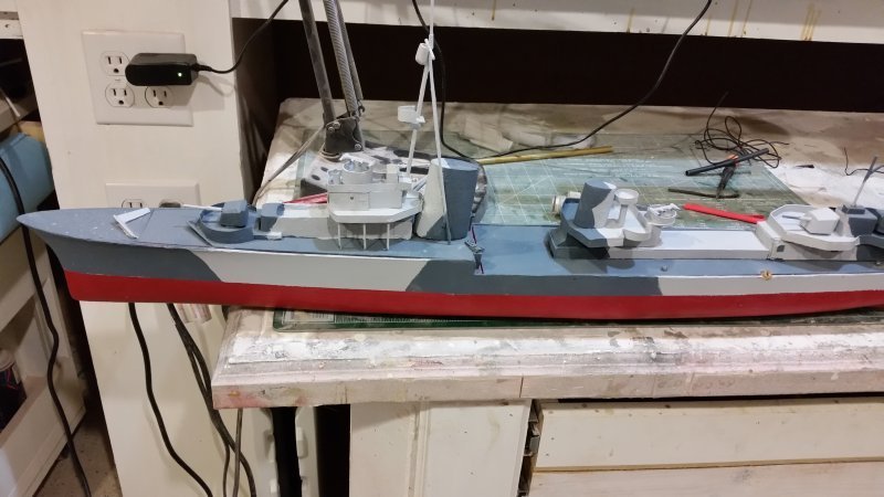

    Overall shot, she is a looker and most of the detail has been left off.

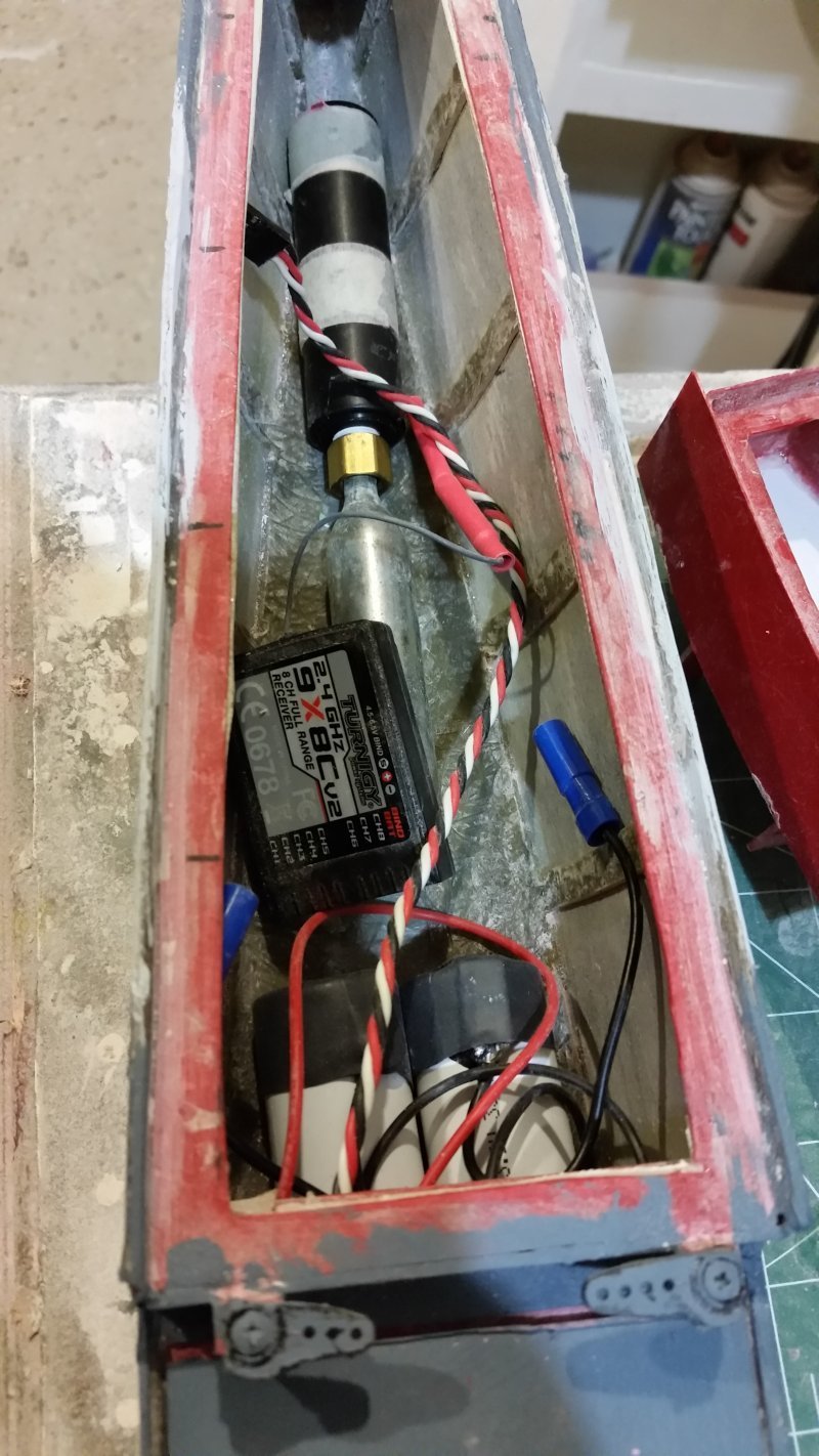

    In this shot you can see the 'rock the boat' regulator and capsule, followed by the receiver (still need to pot it) and the batteries. The two servo horns hold the front deck down.

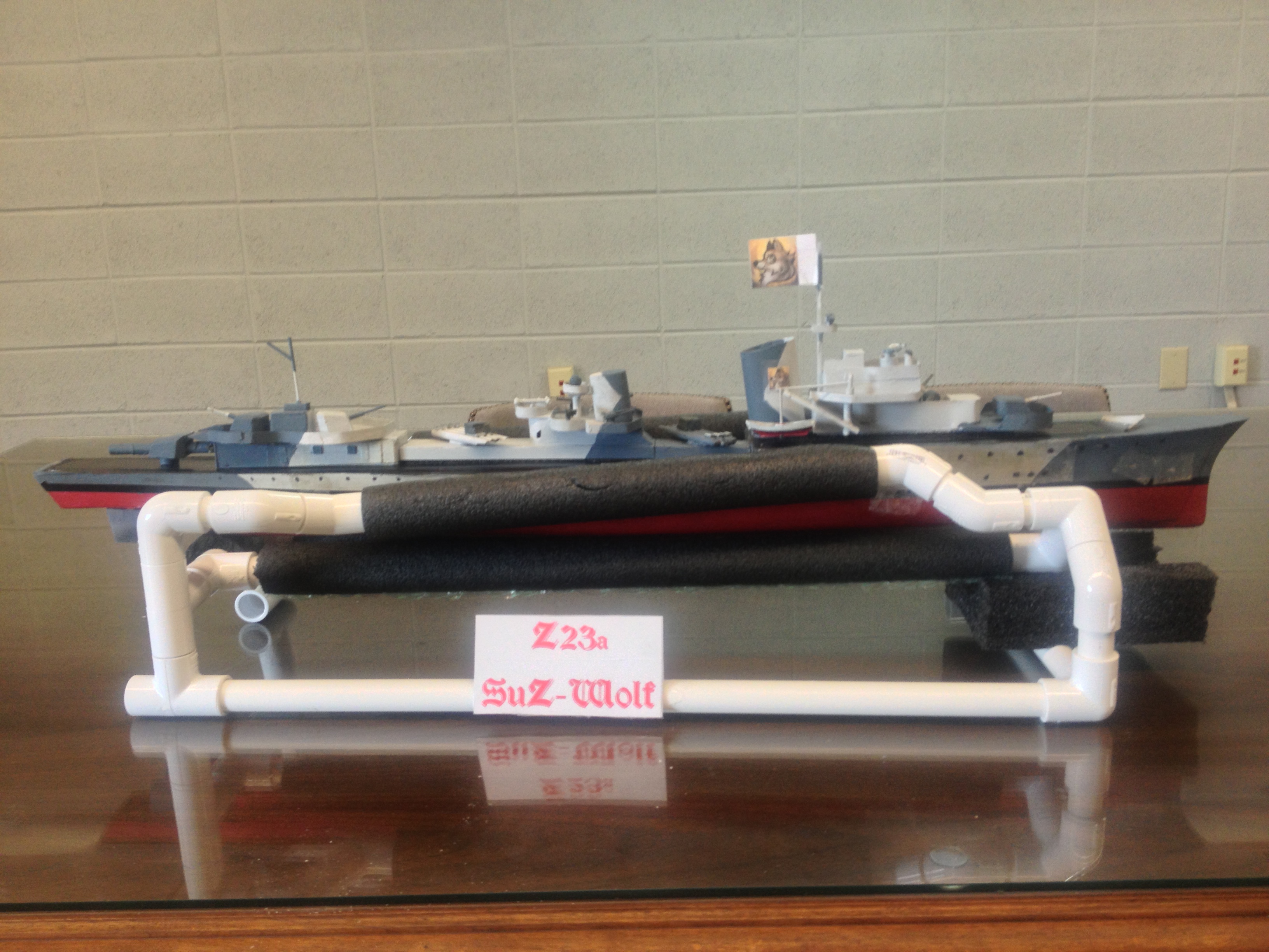

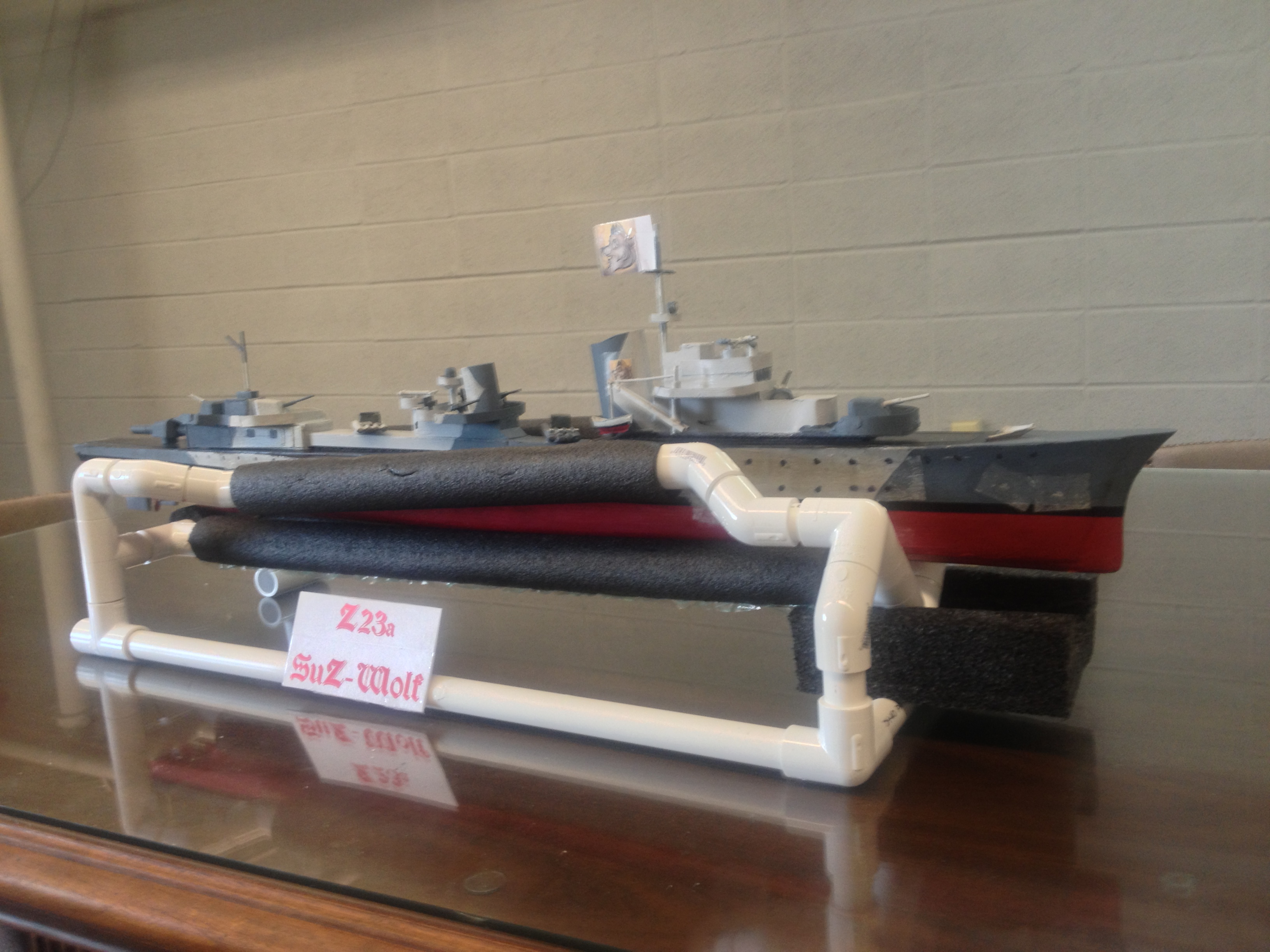

    maybe you see that the deck seal changed (the last two pictures were taken after a change of the deck arrangement. the deck is spray painted black now): having a lot of trouble with the sealing the lower deck and the boat was running full of water very quick (see my introduction why we call her SuZ), i made some changes in the deck arrangement, so that i can seal it now in race boat style with waterproof tape..the deck is sealed now and the only leaks i have is after getting shot...

  12. SteveT44
    "The pump only delays the sinking after some hits... the stream goes slightly up"? Dude, you need a pump upgrade! ;)
    This little guy in my Mogador pushes .8 gallons a minute through a half unit restrictor at 12V. It has a MANLY stream of over 6'!
    Pump info here: COTS Micro Pump | R/C Warship Combat
