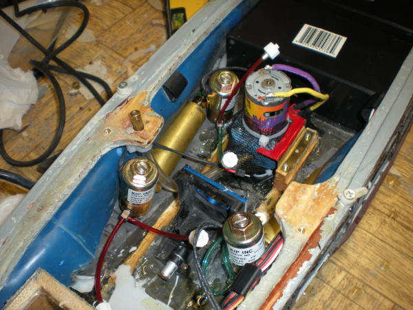

    I am working on getting my Baden ready for Nats. Its taking a while as I am learning as I go. There is not much room in the ship but this is what I have so far. I am having to make a new radio box as my interior armor and wood supports left no space for the larger box.

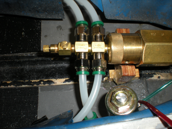

    I am using parker fittings and 1/4 hose. I dont have room or time to solve the problem of expansion tanks so went with two on the stern. I dont have to worry about check valves as all kips have their own feed.
    Here is a picture of the regulator and fittings:
    Here is a picture of the stern area. I have to make some hold downs that will screw into the lexan and hold the kips but I need to go get some more socket head screws first.
    I am interested in feedback.
    Thanks!

  4. djranier
    Everything is looking pretty good. Regulator setup is first rate. What kind of guns are you using, It looks like you have independant magazine feeds?
    You can always just waterproof all the items, and forget about the box, they almost always leak anyways.
    How the weight looking like, the Baden is larger so you should be ok.

  6. jadfer
    DJR - I am using foster breech guns so I need two feeds to the gun from the solenoid. I probably will water proof it all and put it in a box. I like the clean look of the box. I really liked the radio box that Rob used in his Tirpitz so I am using that design to make a new one.

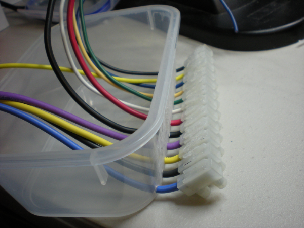

    Here is the beginning of the radio box: [​IMG]

  8. djranier
    Looks like you should flip over the connectors, they will be harder to attach facing down.

  12. jadfer
    I used epoxy to attach it to the side of the box and covered the wires and holes with silicone. I am testing the integrity tonight.
