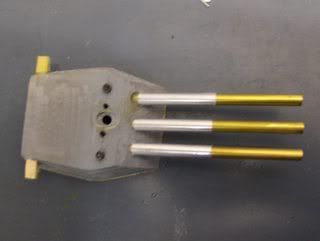

    I secured mine by drilling a hole the size of my Barbette OD threw the deck and than ca 1/32 piece of ply under it and drilling that to the id so it ends up being a shelf than I glued the Barbette in using G/Flex should be able to with stand the impacted of a fully loaded 747 but who knows about a BB will let you know in July [:D]
  8. Powder Monkey
    well that didn’t take long the barbettes are officially tested.[:(!]
    I have to say they survived quit well as for the rest of the deck well lets just say I'm set back a day or two. I had the deck section setting on the band saw table, it is the perfect height to work on it 53” off the cement floor. I turned around for 1 min to get a clamp to clamp it down and yup you guessed it [:0] bombs away smash $#^#&$&@ *chest pain* stunned 1 moment than started picking up the pieces.
    damage report the barbette and super structure minus a few little breakaway antennas and such where fine however the turret was bolted to the barbette with an aluminum bolt it sheared off so I have some drilling and re glassing to do but nothing to bad time to take a break[:(]
