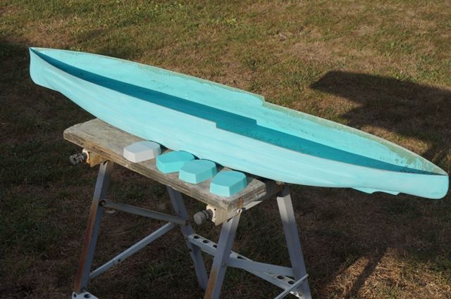

    I have the Hull:D
    I had planned to spread out expensis, but since I don't have Barham plans, the next place to move forward is the drive system. I will be placing an order for some gearboxes.
  16. mike5334
    Where did the turrets come from?
  17. absolutek
    They look like Ralph Coles.
  18. Maxspin
    Maxspin -->> C T D <<--
    Jul 30, 2014
    634
    Yelm, Washington
    Ralph has molds for those. I ordered a set at the same time I ordered the hull.
    Keith
