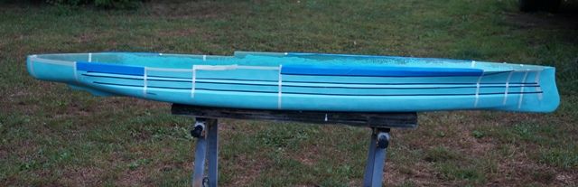

    Here is the layout for required rib locations. Blue tape represents where the hull will be cut for casement decks. I also added tape on the near side to show where I will need to extend the weather deck for the Barham. This Hull came cut to the Q.E. configuration. I finished taping out the remainder of the ribs last night, but it was too dark for photos.
    Keith

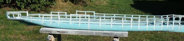

    Well, Ralph did worn me. This hull is very thick.o_O I have been cutting with my dremel two days now, about an hour each day. I am still only 2/3 down one side.
    It will be worth it in the end…..
  12. Tugboat
    Yeah, it took forever when I did mine too. Very good, thick hull. I think I was blowing blue dust out of my nose for a week afterwards.

    Majority of cutting is done. The blue dust phase is complete. :D
    I have started laying out the subdeck. I will be using fiberglass sheet for this. The red dust phase is about to begin.:(
