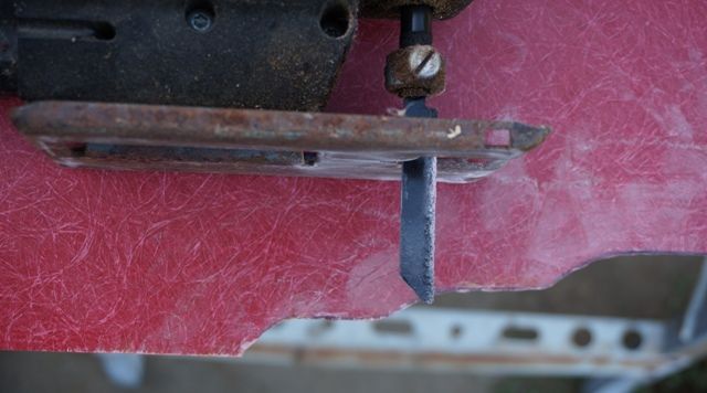

    Found the poor man’s solution. I was looking for an abrasive blade for the scroll saw, but the hardware store didn’t carry them. They did have abrasive jig saw blades. For less than $3.00 I got one. They had two version. I got the course version. It cuts the fiberglass very nice. The thicker leading edge makes turning with the jig saw very easy, making the whole thing much more accurate than a normal jig saw blade.

    Interesting that Red dust is... itchier than blue dust o_O

    All of my fiberglass cutting is done outside with dust mask, safety glasses and long sleeves. With the hull cutting (blue dust) I was able to get away with no gloves, washing my hands after complete. With the deck (red dust) my hands would itch.
    Not sure if there is a difference in the glass, resin or most likely dust particle size. The hull was done with the dremel with a cut off wheel. The deck is with an abrasive blade with the jig saw.

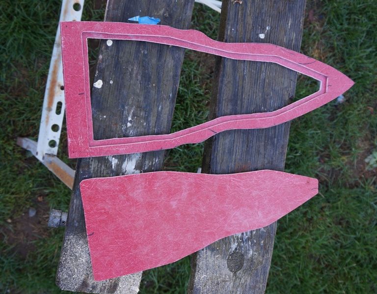

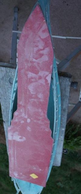

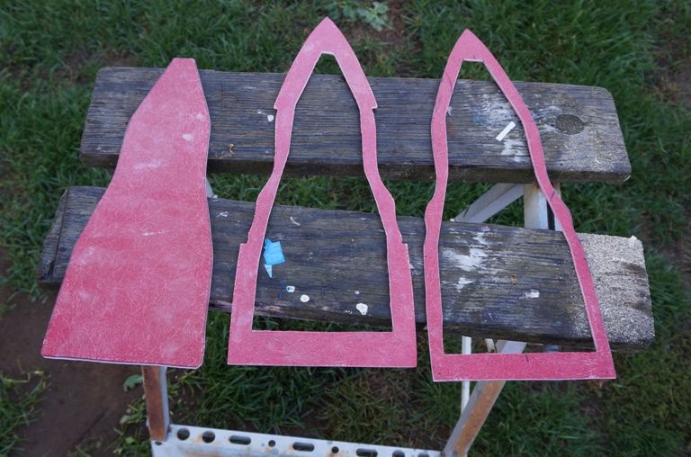

    Mostly finished with the decking. I will glue together the two subdeck rings then glue the subdeck in using West System epoxy.
    You can see where the casement deck goes I only get 1/8” for a deck rim. I cut back the subdeck ¼” to allow a BB to Pass.
    I am thinking that I should have left a cross support in the front. I may epoxy a piece in.
    I need to install the gear boxes and running gear first, so that I have an easier time working inside the boat.

    Nicely done! Stacking plates like that sure makes it easier. :)

    Suggestion on cross brace: Don't install it. Instead put in threaded inserts in the sub-deck and use the main deck to hold it together. This way the hull is at the correct width when the deck is on, and when you have it off there is nothing blocking your access (seems like cross braces are always in the way.
    You could even do post (1/8 brass rod) and holes in the sub-deck to make the cross brace removable as another way to accomplish this task.

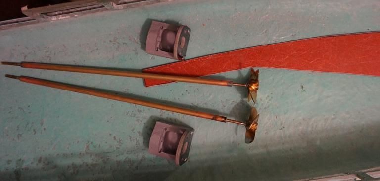

    I built the stuffing tubes and trimmed the props, so that the rudder can be located as close as possible.
    I have been working on the casement decks. I still need to fab some ribs to set the casement decks on.
    I decided that I needed to install the stuffing tubes and gear boxes before I started getting the casement decks and ribs in the way.

    Keith, you are definitely right, doing the shafts before crowding the inside even a little, is a great idea :) I draw circles on the bottom of the hull where the barbettes go, so I know where NOT to put my gearboxes (and I have the gearboxes on the stuffing tubes while the epoxy sets) so that I don't have trouble with gun fitment later. Of course, if you're shoehorning 3 guns in the stern, it's gonna be crowded no matter what :)
