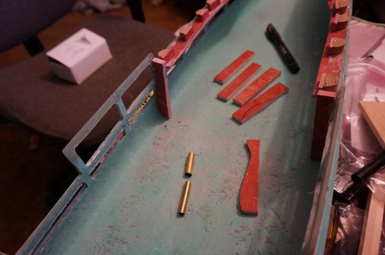

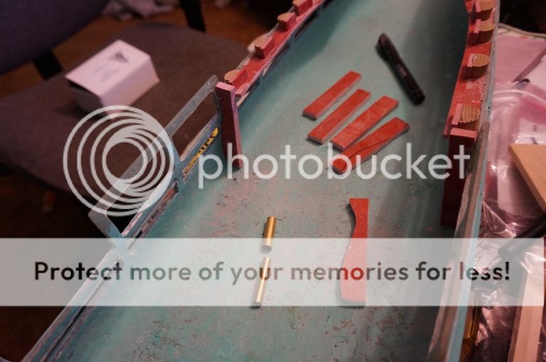

    More fun with the pink itchy...
    Been working on the ribs. I have to find time when I can work outdoors (no rain) have light, don't have list of honey do's.....

  14. irnuke
    Boy I bet that stuff's fun to cut curves in
  15. Lou
    After building mine to fit the shape perfectly, I would not do that again in the bulge area. You *might* want to fill the bulge so water does not collect there, so on the ribs only worry about the gap 1/4 past the bottom of the window. When all the ribs are in place, put the ship on a 45 degree angle and use epoxy to seal between the ribs and hull. That will fill any gaps. Speaking of which, don't forget to rough up the inside of you hull now before you start attaching the ribs. If your budget allows, take a look at the epoxy putty to use for filling instead of balsa. HTH...
  16. Lou
    Tough to cut, but very easy to grind with a belt sander or dremel drum sander.

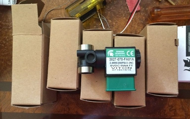

    A couple of more pieces of the puzzle!
    Ordered through US Plastics.

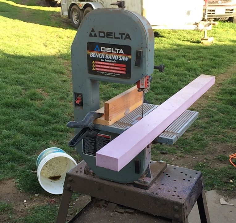

    Finally had a couple of hours with some good weather to work with. I finished grinding out the ribs and did some prep work for the water channeling.
    I am planning on using pink insulation foam for the water channeling. First step is to get it to a workable size.
    I dragged the band saw out of the barn and cut (2) 4’ section off one at 3.5” and another at 2.5”
    Set the stop and cut off a chunk.

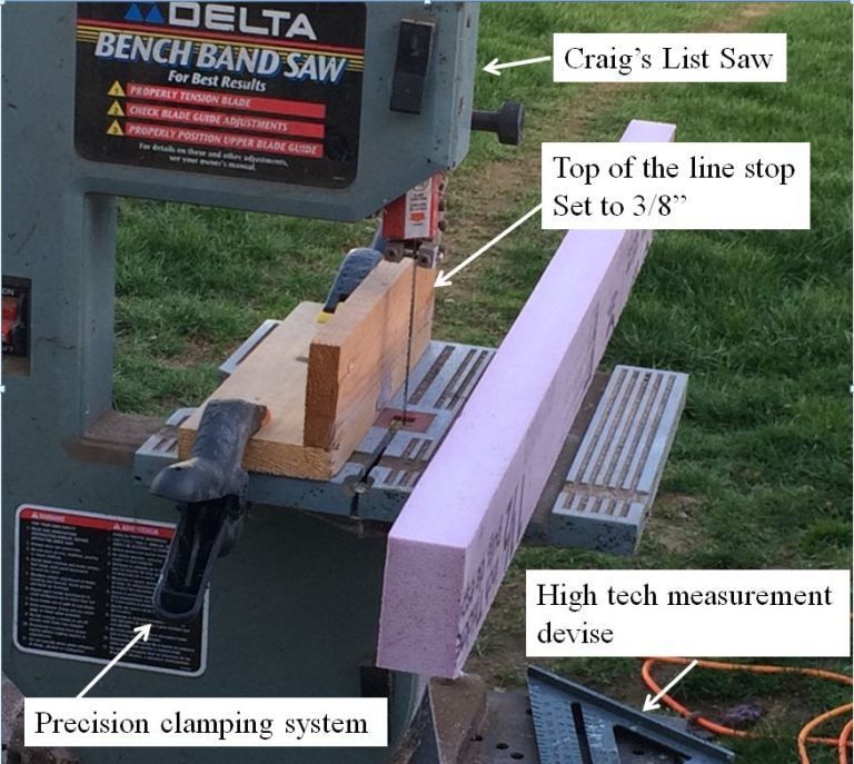

    A little insight into Keith's "shop"

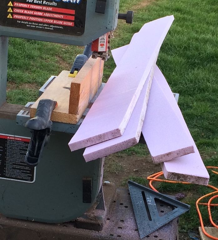

    Reset the stop to 3/8” and slice it up.
    Tugboat, SteveT44 and NickMyers like this.
  20. Tugboat
    Wow, we use the identical high tech measuring device!! How cool :)
