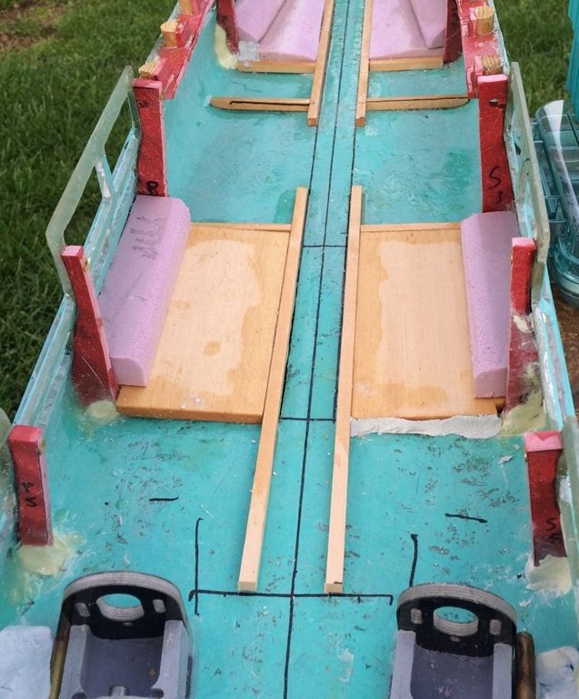

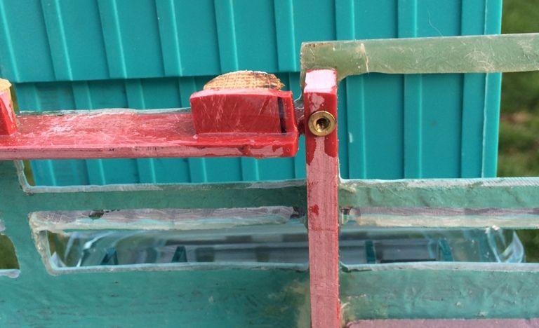

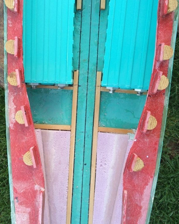

    I have finished and installed the ribs. I made 8 ribs per side & included an insert at the top to attach internal armor to.
    CURT and Tugboat like this.

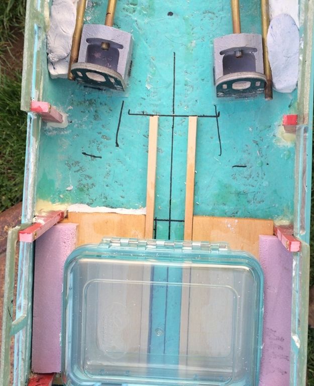

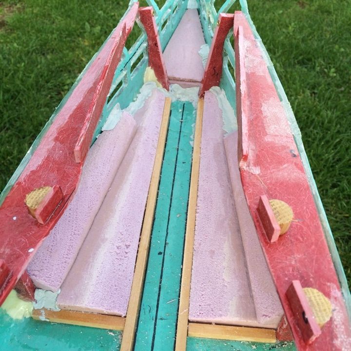

    Water channeling is started
    I have left space in front of the batteries and aft of the Water proof box for ballast/trim as I finish it up.
    Water proof box is a GSI Outdoors XS Lexan GSI Lexan Gear Box | Water Tight Cases | BackcountryGear.com it is wedged between foam to keep in place.

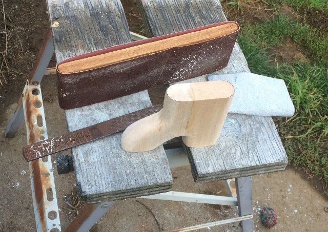

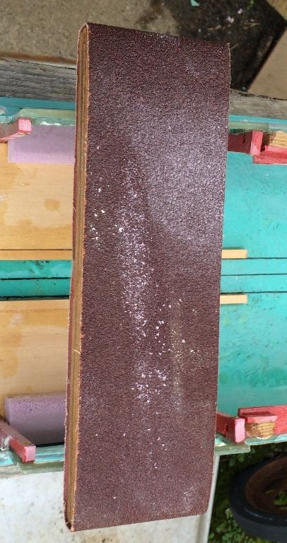

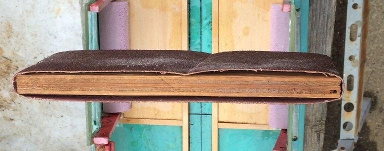

    Here is my foam tool. It is a 40 grit belt sander belt over a piece of ply wood. It makes short work of foam, but the particles are big enough to fall not float about in the air.
    Tugboat likes this.

    What adhesive did you use to glue the foam to the hull?
  11. Maxspin
    Maxspin -->> C T D <<--
    Jul 30, 2014
    634
    Yelm, Washington
    West System epoxy. It does not eat the foam.:)
    Great. I had issues usong an adhesive that would not eat the pink foam. I like to use it again so this will help. Tks.
  13. Maxspin
    Jul 30, 2014
    634
    Yelm, Washington
    I have had bad experiences with other adhesives as well. Bondo is bad........ JB Weld WaterWeld worked good as filler.
    CURT likes this.
    Hmm will have to try that.
  15. ish311
    ish311 Active Member
    Aug 18, 2014
    527
    North Central Florida
    water weld works. super 77 works. tightbond III does an halfway decent job if you can get pressure on the foam first.

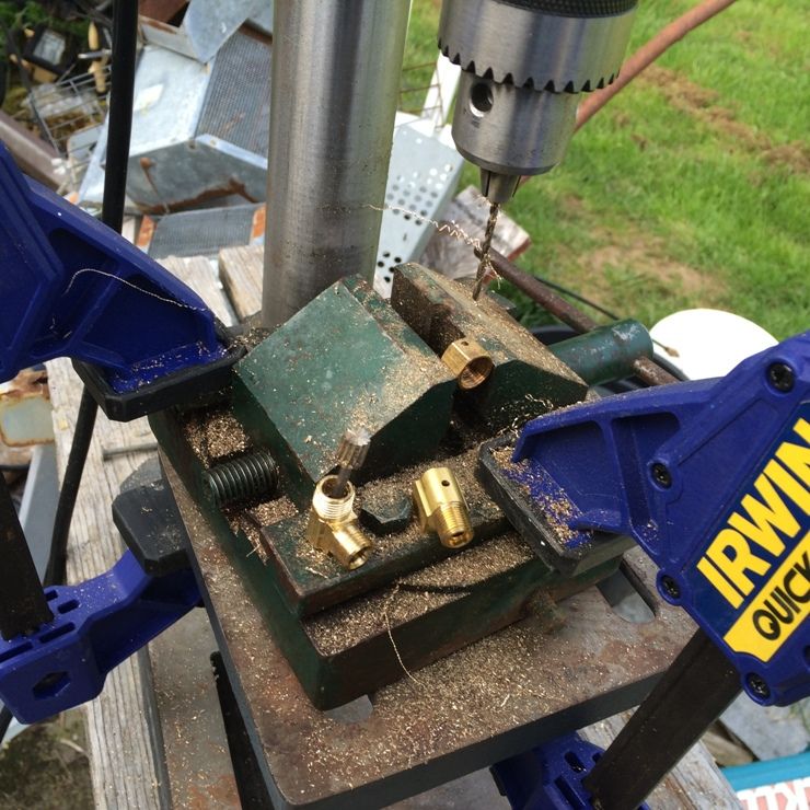

    Weather is improving. Maxspin armament factory is starting production.
    McSpuds and NickMyers like this.

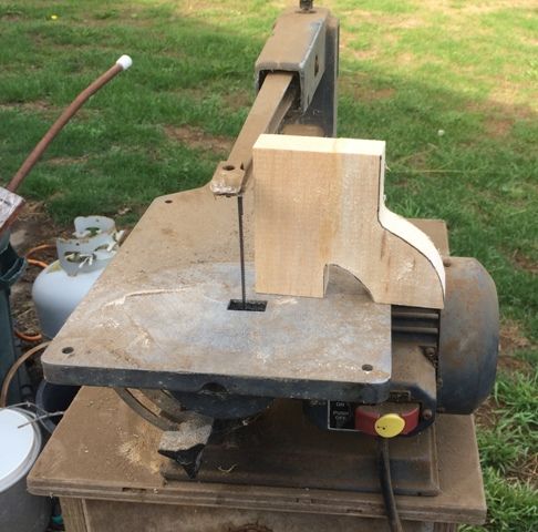

    Work on the Barham got stalled over the summer. Battle upkeep on the Washington used up most of my free time.
    I had been dreading the stack on the Barham and had been putting it off. 3DP envy:crying:.
    As it turns out, It was quick and came up pretty good.

    2-4 layers of light fiberglass.
