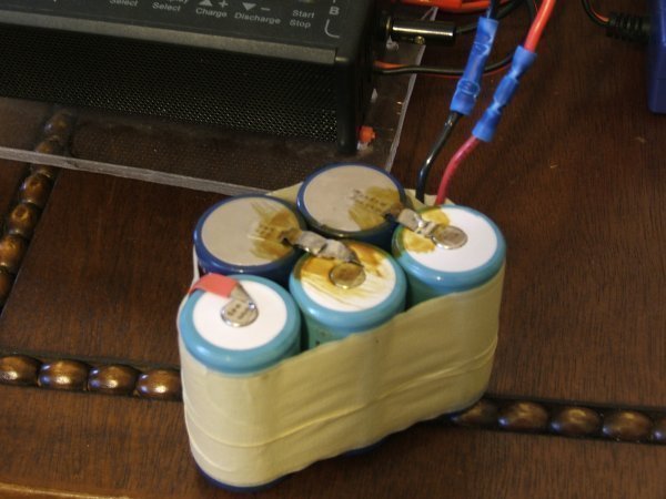

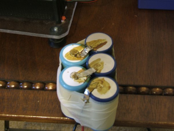

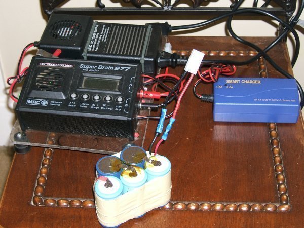

    Okay so I'm trying to make a 6V pack using tabbed 10AH D cell batteries. All tabbes are soldered and are showing little to no resistance on my meter. All batteries are connected negative to positive and what not. The problem is that when I plug the pack up to my Super Brain 977 it registers error and even the little smart charger that came with the batteries doesn't see them. Both of the chargers have no problems linking up to my two earlier packs. Here are a few pics:
    I've been having problems from day 1 with batteries and I am at wits end. Does anyone have any suggestions / things to try / thoughts of wisdom anything?

    Well, here is my general "Pack troubleshooting" list...
    1. What is the voltage at the connector? Is it greater than or equal to the number of cells times the minimum cell voltage?
    If the answer is NO, you have a bad connection somewhere or a bad cell or have overdischarged the packs... many chargers have trouble with over discharged packs, and you have to get the voltage up near the normal min/max range before they will connect and charge.
    For a bad cell, check voltage across each cell. actually, that is generally a good idea anyways, as all the cells should be at about the same voltage. If one cell is really low compared to the others, it probably has died. A note that improper (or unlucky) soldering has killed many a cell over the years.
    My fist thought on looking at the pics was...
    'CRIMPED CONNECTORS!!! ON THE BATTERIES!?!?!!?!! PRIVATE PYLE, YOU ARE IN A WORLD OF SH**!' (Crimped connectors in the middle of a flexible wire run, in an application that calls for repeated handling (taking batteries in and out) is asking for trouble. You're a nice guy and I don't want that to happen to you. Strongly recommend soldering all connections where you aren't using Dean's or Powerpole connectors. I have both types in various boats and they work equally well. Dean's are more compact, Powerpoles are cheaper. Either one is 100% good to go.
    After the moment passed, I thought along the lines of what Greg said. Check the voltage with a multimeter at the plug of the battery. Also, just to be sure (Having been an electrician in the Navy, I know that if anything on my boats is going be wrong, it'll be electrical. God has a sense of humor.) double check that the red wire is in fact attached to the positive termal and the black likewise is on the negative. If that's backwards, everything will look good but the battery chargers will show an error.
    Edited to add mininovel on why crimped connectors are suboptimal :)

    Yea I agree with the crimp connectors...That was simply a function of me thinking I might have possible made a bad connection with the end wires. So I had my dad look at the pack with his meter and he is pretty sure that it is probably just that the (Bran Spank'in New) batteries have no charge in them as all the connections check out. So I've got to try and find a "stupid" charger to see if I can put enough of a charge on them to be seen by my smart chargers....Sigh...Thanks for getting back so quickly on this...I was almost ready to just shelve the entire boat for a while...
  5. mike5334
    You might try a couple things with your charger. You can bumping up charge voltage by 1 to 1.5 volts (or one more cell count) to get it charging.
    Those 10Ah D cells are somewhat notorious for being a bit difficult to charge with some chargers. My semi-smart charger won't do it. My pretty smart yet simple charger handles them ok.
    Don't forget to cycle the pack 5 times or so to "break" them in. The battery chemistry has to settle with a few charges. Once it does that, capacity and amp draw will reach the advertised levels.

    So get this, I was checking all the other batteries that I bought at the same time as the ones I used in the pack for this thread and every last one of them is dead as a door nail. 20 batteries shot to (insert appropriate expletive)! My father brought over a stupid charger and managed to get enough juice in the pack to let the Super Brain 977 see it and I'm going to put it through a couple trickle charge cycles. Maybe I can at least get someing out of it.
