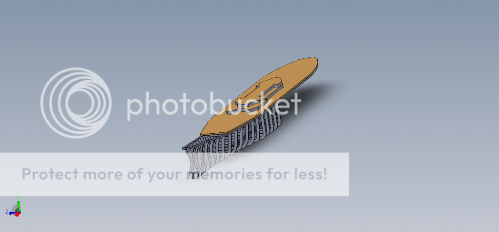

    Just a little sneak peak at what I am working on:
    The ribs are set 2" apart, just to give an idea of the scale.
    Ribs and cap rail are 1/4" wide. Ribs are 1/2" thick.
  7. Beaver
    WOW, very nice work there! :) I've got to learn how to do stuff like that. :)

    Im pretty much self-taught how to use SolidWorks. Ive done a lot of smaller models of paintball gun parts and I can do a lot of simple design work. This is my first 'big' project. That is only the mock-up assembly. The ribs will need customized to each section and notched for the double keel and recessed for the cap rail to sit and hold them in place.

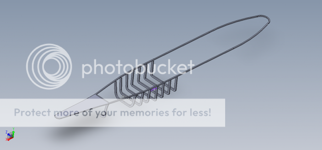

    Just a little more eye candy...
    There will be a buid log with all of these, but I figured I would give you guys a sneek peek.
    My CNC shipped today so I should be able to start cutting wood in the next few weeks

    Thanks! As soon as I am done with the CAD drafts I will start the build log. The CNC will be here tomorrow, and be built by this weekend. Unfortunately it only has about 12"x12" working area, so I will have to do some fancy trickery on the longer pieces like the keel.
    I think I still need to work on the bow. I think the tear-drop looks a bit too big.
    What you cant see in the picture is the double keel and 2" water channel starting at Rib 10. Everything is notched and interlocked, so I am hoping for a solid construction.
