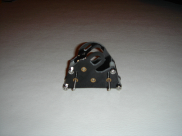

    Can anyone tell me what the distance is between the two output shafts in the Battlers Connection one motor/two shaft gearbox? (Need to know before placing an order and thought I might get a faster answer here.)

  5. djranier
    Distance between shaft centers is, 1-9/16 inch.
    What I like about it is that the output shafts can be reversed so that the motor sits to the rear of the gearbox. But it works either way of course.

  6. Bob Pottle
    Thanks David,
    The only models I've built with prop shafts that close together are of Class 3 and below. Just measured the Indefatigable and Furious hulls - the gearbox will barely fit the Indefatigable without the props hitting the hull but not the Furious, which has a wider stern skeg. I'll order one for the I-boat.
    Bob, I used my drill press to make a gearbox for the Australia from some aluminum box section (1/8" wall thickness, 3/4"x1.5" section)... While my shafts are pretty close together, I had contemplated fabricating one with an extra gear between the two large driven gears to spread the output shafts further for use on a larger ship. Not too hard to do if you have a drill press, and the box section aluminum is pretty cheap.
