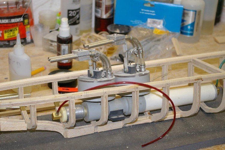

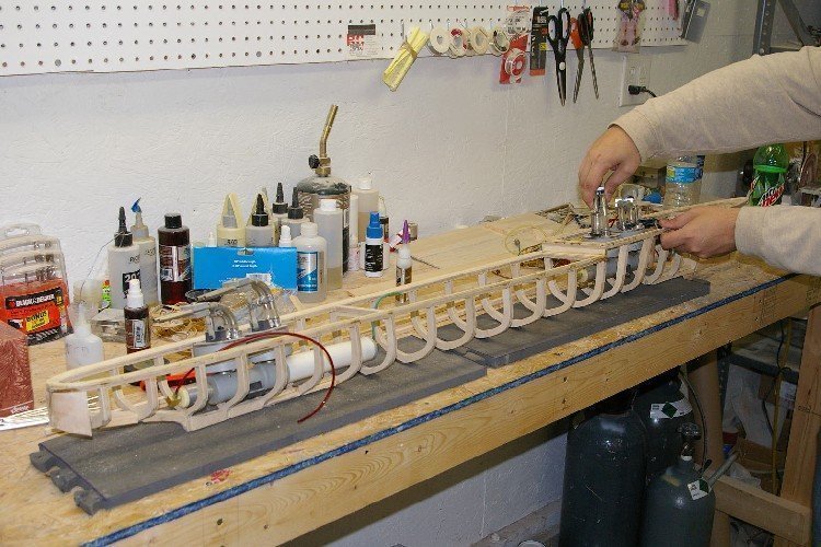

  5. Kun2112
    Internal layout test...Please forgive the tubing, everything is still plumbed from the previous boat, and I did not feel like messing with it.
    The large white object inline with the tank simulates a larger size tank. The other two plastic bits simulate Clippard volume chambers for Arizona style torpedoes..
    The ESC is directly in front of the stern cannon accumulator, then the pump, then SMAV-3s & servos, space for regulator, tank (7oz hopefully), then bow cannon. Underneath the bow accumulator, in the water channel sits a 6.6v 2300 mAh LiFePo4 battery pack. Also note the sail winch servos (well one's a hacked HS-322). These might get changed to the Vigor sailwinches Strike carries
    Battery load for motors should be about 0.80 amps (2 Maxxon-A's) and 0.20 for the pump.
    This is all very preliminary until I get the shafts & motors in.
    I also may not be able to have all the goodies due to weight...

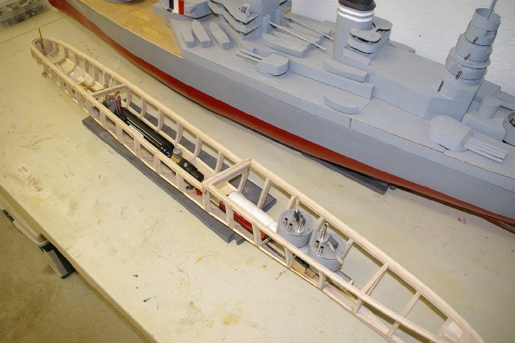

  6. Kun2112
    Hmmm...
    Weight is 8lbs right now. No regulator, no rudder, no motors, no props, no shafts, no torps, no fiberglass, no superstructure, no ammo.
    My math says 7.5lbs standard displacement and 10 lbs full load
    :ermm: :( :crying: :sick:
    Ok, Time to look at the things I cannot change:
    Hull - can't really do anything here rigth now 17oz and counting. still need to glass, etc...
    Cannons - might drop the stern or bow gun. 26oz each
    Battery - 6.5 oz for 2300 mAh
    Esc & servos - 10oz . if I drop one rotate and switch from HS-765HB to Vigor I can get down to 6oz
    Tank - 17.8 full 14.3 enpty (which it is now)
    That is 6 lbs. 4oz as is and 4lbs 6oz dropping a cannon and changing servos
    add plumbing, pump, deck......everything else

  11. Kun2112
    Well after a late night and an early morning, I came to realize that even dropping the plumbing weight, I still really will not be dropping that much. I will probably drop the stern assembly which will free up a total of 28oz, and look at reducing weight on the brass bits while I'm at it.
    It was going to be a real challenge getting everything to fit in the first place, hitting my target weight and keeping trim/stability under control were just going to add complexity.
    It really bums me out too as I spent two evenings getting the mounting point for that rear assembly to where it sat low enought to clear the deck for rotation without messing up the hull contours.
    Besides, there is absolutely nothing in the rules that says I cannot use a couple of fixed fast gun cannons :D

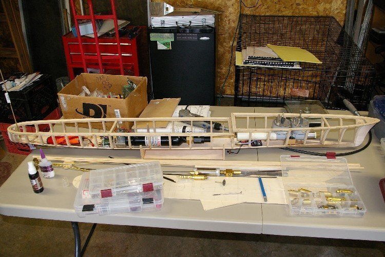

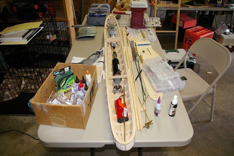

  12. Kun2112
    Well, I got the shafts in today with a lot of help from Mikey. I had to cut out part of the stern mounting point. There is no way the stern assembly will fit now, but that is a good thing as makes me focus in other areas that need it instead of obsessing on fitting those two turrets in.

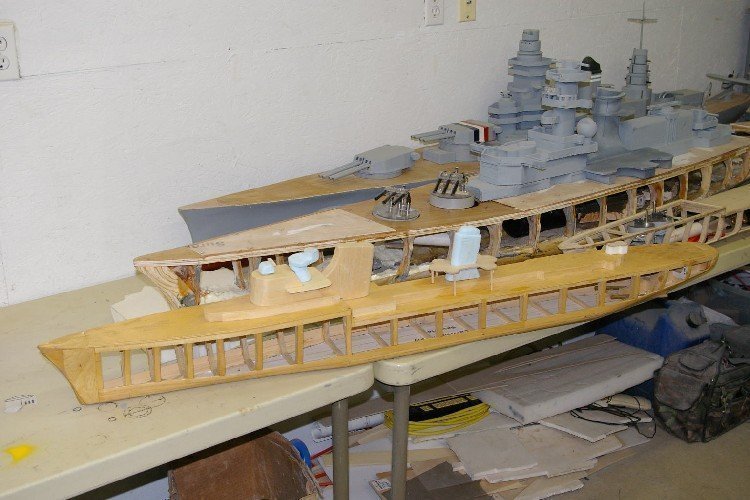

  14. DarrenScott
    Looks like you could save some room in the bow with a shorter, fatter accummulator on the bow cannon. There's probably a fair bit of "meat" you could shave off both cannon bearing mounts as well.
    Have you taped her up and floated her to see how much she can actually carry?

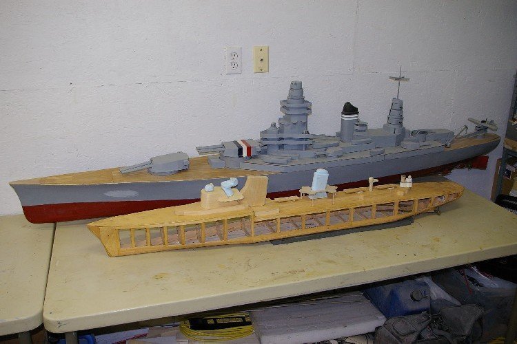

  20. Kotori87
    Ahh, so much more spacious now that the rear guns are gone. There's suddenly room for everything. Do I see an MJV torpedo cannon under construction on that table?
