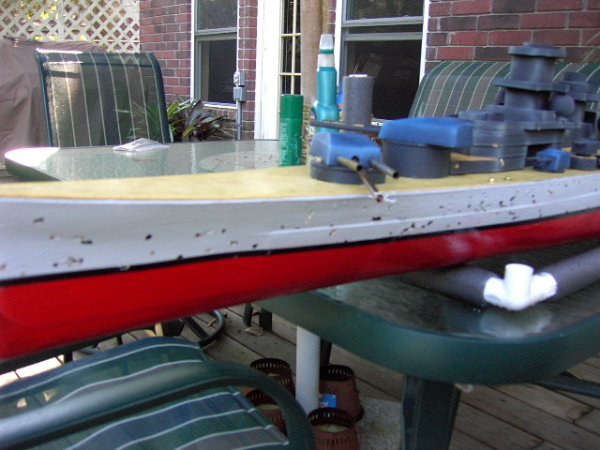

    a friendly port with a good vantage of the battle dammage...

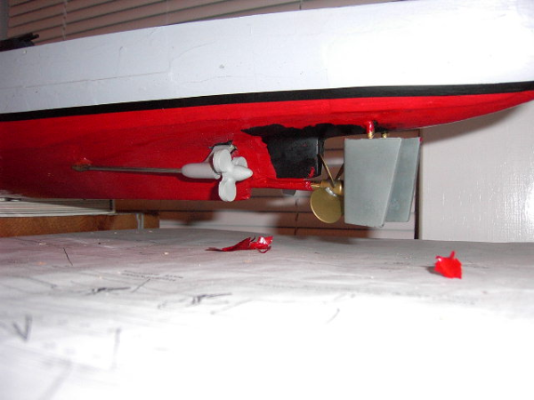

    Below is a picture of the stern of the Scharny showing the skeg, prop, and rudders. Two things you have to be careful about when drilling your hole is that the exit is low enough for your prop to clear your hull (put your prop up against the skeg and mark with a pencil how low it has to be so it can clear - the bottom of my prop was about a 1/4 inch from the bottom of the skeg). The second thing you have to worry about is having a wide enough surface to drill your hole without cracking the hull. I ended up carving off the bottom 1/2" of the skeg back 2" to where it had thickened to the point where I could drill the exit hull (I used a dremmel tool with a cutting disk for this). I started by drilling a pilot hole with a 1/8" bit, and then followed up with a 1/4" bit with a 12" shank. You will probably need to use the drill or a grinding bit to cut a groove for shaft as it enters the hull (the point where it enters will be a tight fit). This is why I used a bit with a long shank. You probably also want to make sure you have a little play in the exit hole so you can adjust and aling your motor mount (the exit hull will be epoxied over anyway so if it is bigger than nescesary it is no big deal.
    Also
    I was told to try and have my prop as close to the skeg as possible, so mine extends past it by about an 1/8" only (this is hard to see as my red paint has peeled off, the skeg actualy goes all the way out to the end of the stuffing tube.
    Also note I mounted my rudders down about 1/4" in order to be in the full wash of the prop to aid turning.

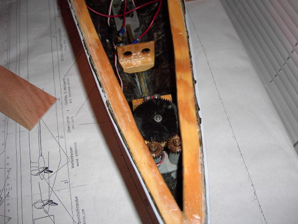

    Below is a pictur of the engine mount. I was told that it is best to have your prop exit as close to horizontal as you can. I was able to get mine to exit nearly straight. in order to do this you will need to make sure you motor mount is as far inward as you can get it (i.e. use your entire stuffing tube), and then grind down the corners and bottom of the motor mount to fit the countour of the hull and sit as low as you can get it. This took god-awful forever for me, as I did it with a sanding cylinder on a dremmel. You need to be careful when you grind because if you are too agressive you will expose the screw channels for the mounting plate.

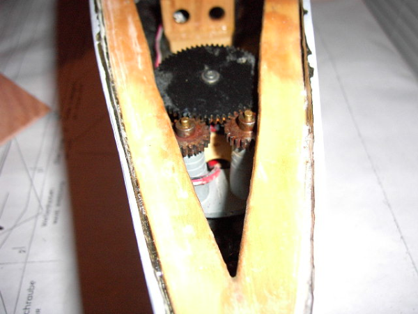

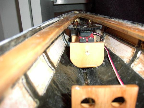

    Below are three pictures of my rudder mount. The Scharny has a very narrow stern that was a pain in the butt to work with. What you will want to do is start with your prop mounted, and then drill you rudder holes so your rudders sit as close as you can get them to the prop (mine are about 1/4" in front of my prop). You will probably want to drill your holes a bit larger then nescesary so you can do fine alignment of the rudder when you stick them in. I actualy fitted my posts in first, tacked them down with a tiny drop of CA glue, and then drilled right down the post hole (minus the brass insert) with a 1/8" drill bit.
    In order to get the mounts in I first glued my two posts together by their edges so as to insure they would both be sticking straight up. This also had a nice side effect of making the posts exactly one inch apart (which is about the distance I wanted the rudders to be apart anyway)) I ground down the front of the bases of the two posts into a bullet shape to fit into the declining countour of the stern, and rounded the heck out of the bottom to sit as low as I could get it. I also had to lop off the first two rungs off the top in oder to get clearance for my gears. I could never figure out a way to use the rudder arms so I opted to buy gears instead. Traxis has a gear that is already threaded for the futababa servos that I highly recomend.
    My servo mount is a piece of garbage and badly needs to be replaced. David Ranier has a much better mount on his ships (using aluminum). I basicaly built my wooden mounts, screwed on the servo, test fitted it in the hull, and then cut down my posts to the right height where my gears would mesh with my servo gear.
    P.S. if you use gears make sure your set screw is on top (not on the bottom) when you mount it. It will be, shall we say, a wee bit hard to get to if you have your posts set up with your gear mounted upside down.
    Also, Your gears will in all likelyhood extend under your subdeck. The hub of mine actual extend up past the bottom of the the subdeck and almost touch the bottom of the deck. You may need to grinde a shallow dish out of the side of your subdeck to make sure the top of your gear does not rub against it.
    P.S. I understand that you can get a low profile servo (mine is standard size) that can help you mount your rudders (as they will not have to sit quite as high as the servo is only half as tall). You may want to look into one of those if you have trouble with your rudder. You will also want a rudder servo with a bit more torque than your standard servos, as you will need it for turning.
