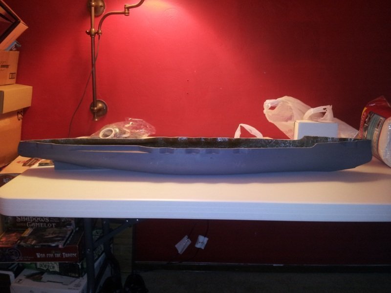

    Well, here is the hull the day I got her unpacked and looked over.

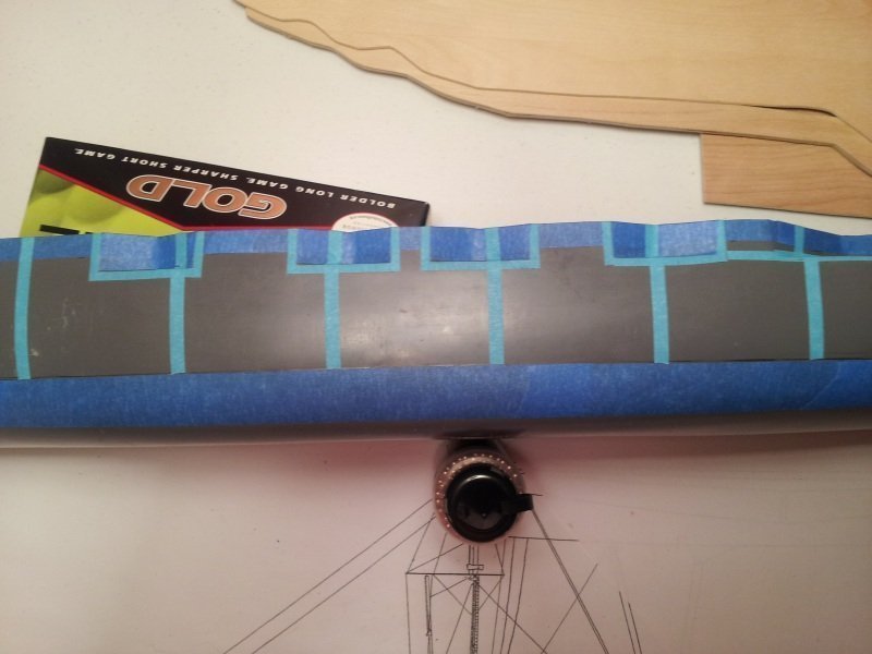

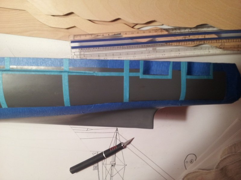

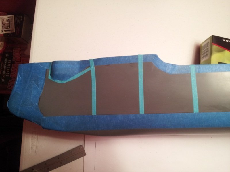

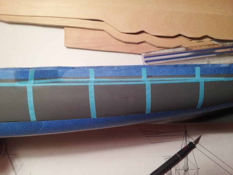

    After a refresher on the rules I taped what I believe are the allowable impenetrable areas. I went with 16 1/4" ribs spaced roughly every 2.75" and the scale waterline.
    I think I'm going to slide a few ribs around to match the edges of some of the casements for ease of cutting and strength.
    Now for questions: Do the impenetrable areas look right? Am I allowed an 1/8" inch stringer between the various casements and the small subdecks?
    Also, I'm looking to order the final pieces in the near future, so any suggestions on batteries, servos, ESC, or radio would be greatly appreciated.
    Solid areas look good, but that one on the casement bulge at the bow should go straight up, not angled to the corner. I heartily concur with your plan to move the ribs a little to line up with the edges of casements, etc for an easier time cutting. I think you'll enjoy the VDT, it's a good solid ship with a decent amount of room. And it's Axis. :)

    You do not get a 1/8" stringer at the bottom of the windows right above the small casement decks.
    It looked to me like he was splitting the 1/8 above and below so that he had a lip to glue the balsa to; is that illegal? (honest question, not being an @$$) :)
  5. Renodemona
