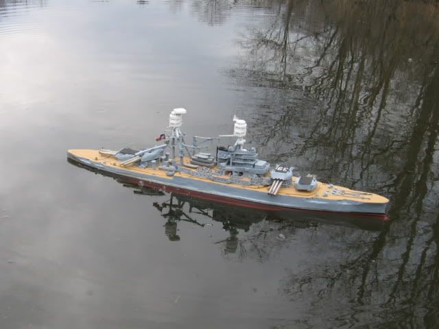

    I also don't think much of the Arizona...
    Not totally finished yet, but here is a link to my building it over the last year from the Strike kit. It's all been very very easy and fun to do so far. http://www.rcnavalcombat.com/Forum/...fault.aspx
