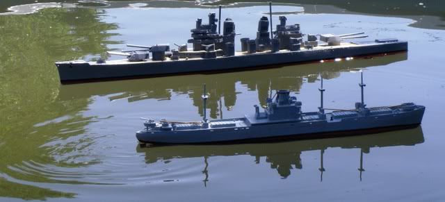

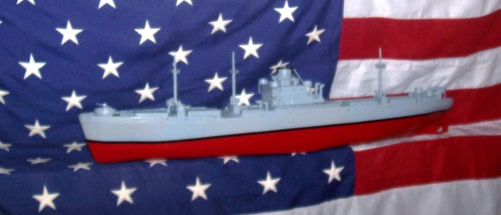

  13. Powder Monkey
    I’m not sure if you have a weight limit or not I used a ton okay maybe not a ton but a bunch of old lead for flashing a chimney on the bottom to get my kids liberty to float right try that if you don’t have weight limit[8D]
  14. Powder Monkey
    you can see her here in the forground

  16. Powder Monkey
    it looks cool but it was mostly to cover all the crap in the back ground [:D]
