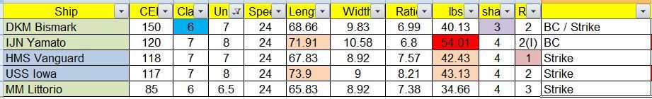

    These boats are huge!!! They are long they are heavy, they don’t fit in your car, they are difficult to launch, and are even more difficult to retrieve from the water, they have a lot of freeboard (read easy to hit). The guns are mounted high (read easy for small ships to slip under bow sidemounts). A lot of captains run 2 pumps in these making them very difficult to sink, but the amount of damage given compared to damage received would not make them an admirals choice. (for those who count holes)
    Generally speaking because of their length these are not the most maneuverable boats out there. The one exception is the Bismarck. The single large drive prop with large drag props creates an incredible amount of prop wash vectored through dual rudders. I would never build any of these.

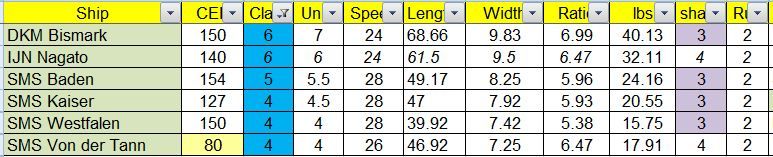

    Best of Class Bismark AXIS
    6 Unit

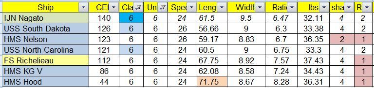

    We can immediately remove all single rudder boats. Even with the 1.5 bonus for over 700’ they still do not turn with a dual rudder boat.
    Nelson’s and Richelieu’s all forward gun design is a poor option for this hobby.
    South Dakota, North Carolina, and Nagato are the only real options. Nagato’s haymaker option and Casements, makes it the hands down winner.
    Best of Class Nagato AXIS

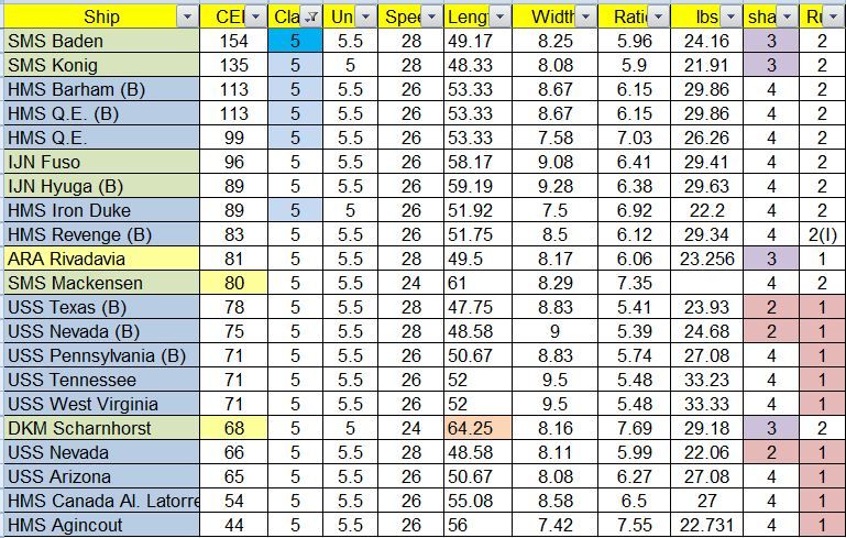

    Again we can eliminate all single rudder boats. None of the Class five boats even get the 1.5 rudder bonus. These ships are severely handicapped by our rules. The single drive prop make the Baden and Konig stand out. In spite of the slow 28 speed, their maneuverability more than makes up for it. You can run away from them, but engage at your own risk.
    Queen Elizabeth and Iron Duke have good maneuverability and speed. Not fast enough to run with the big boys, not quite as agile as the Baden and Konig. Good all around boats.
    Fuso and Hyuga. Length will hurt them, but they sit low in the water and have good gun placement and casement protection.

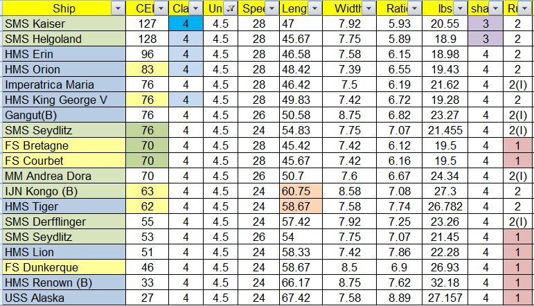

    Again, single drive shaft boats will be on top, and single rudder boats are out of consideration.
    Battle Cruisers take a hit due to their poor length to width ratio.
    I see a lack of fiberglass hulls in this range. Kaiser, Helgoland, Erin, Orion & King George V would all make serviceable boats.
    Best of class Kaiser
    4 Unit
    I will split this between dreadnoughts and battle cruisers.
    Repeating theme here. Remove single rudder boats..
    Nassau is standout do to Best Length to Width Ratio in hobby compounded with single drive shaft and dual rudders.
    Best of Class – Nassau AXIS
    I will address the (4 unit) battle cruisers separately because they are often suggested as good rookie boats.
    Von der Tann is short wide and has good casement protection.
    Moltke is the longest of the three and does not have dual rudders. It is significantly larger than the other two making it the easiest to build. Sits low in the water making more difficult to hit.
    Invincible is narrow, and has no casement protection. It is particularly vulnerable to aft cannons.
    Best of Class – Von der Tann AXIS

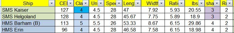

    There are 3 ships that I think that there could be a market for in fiberglass hulls.
    HMS Barham – Queen Elizabeth class Dreadnought. WWII version of this ship has bulges and casements. As I have pointed out the Allies need all the help they can get.
    HMS Erin – Good length to width ratio, good turret placement, dual rudders
    SMS Kaiser – Killer class 4 Axis boat. Like they need another one.
    SMS Helgoland – similar in size to Kaiser, but wing turrets make it less desirable.

    COMBAT EFFECTIVENESS FACTOR
    Manuver factor = (length^3 * rudder factor)/(rudder area * beam * 144)
    rudder factor is:
    Prop #
    ruddertype 2 1
    1 1 .8
    2i .6667 .6667
    2t .5333 .43
    Fire Power factor rated by cannon mount locations
    Bow sidemount 825
    stern sidemount 990
    twin sidemount 990
    stern gun 400
    Bow gun 200
    Stern guns have an additional multipler due to knocking chuncks out
    # of guns Multilpler
    1 1
    2 1.1
    3 1.2
    4 1.4
    So add all your cannons up and get the fire factor.
    Speed number:
    21 1.6
    22 1.5
    23 1.4
    24 1.3
    26 1.1
    28 1
    30 0.9
    So for the final Combat Effectiveness Factor (CEF)
    CEF= (Fire Power* Speed number* 100)/ manuver factor.
