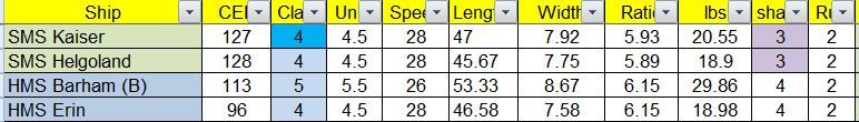

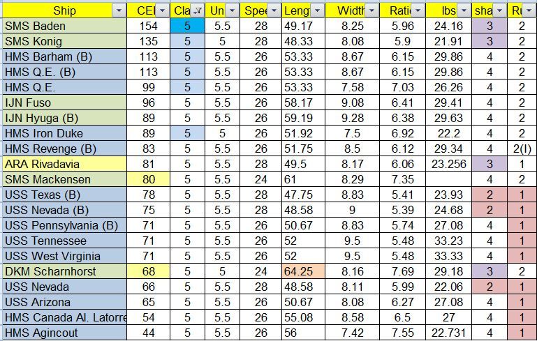

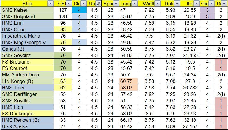

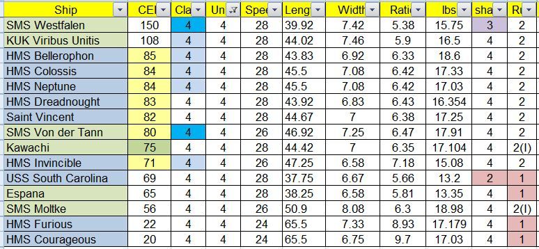

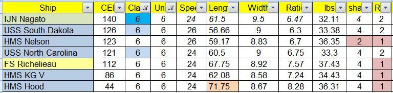

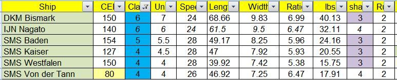

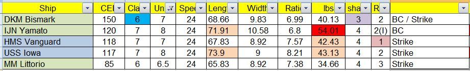

    I have found the difference between single and dual rudder to be quite significant.

    I always though the allies had a much better selection of ships in the higher end, since they had much bigger navies. It interesting to see another perspective, but at the end of the day, at 28 seconds, a Baden can only eat someone that lets it. I think that's a negative not adequately calculated here.

    I believe it still breaks down to 3S/2R > 4S/2R >> 4S/1.5R >>>>> 4S/1R >>>>>>>> 2S/1R. I dont know where 2/2 falls in there, but it only occurs on a couple oddballs so it hardly "unbalances" a fleet.

    The "unbalance" come from 3S/R2 vs 4S/1R:bang:

    Regarding Treaty format, the speeds based on actual ship speed changes a lot. The fast battleships actually do very well Treaty (such as the Richelieu) mainly due to the greater speed and water flow over the rudder(s). The barn burner turning ships in fast gun do not turn as well in Treaty because they are usually slower than fast gun speeds. The upshot is the good fast gun ships are still pretty good while the "dogs" in fast gun are actually competitive also.
    One ship I didn't see on the list is the Erin for 4.5 units. I'd rank it up there with the I-boat and possibly even better due to low profile, favorable gun placement like an ID, and half decent turning.

    Erin is on my list. In fact I put in on a list of ships that I wish the hobby had a fiberglass hull for.

    I like this . Well done. Agree with your summarizations. I seen Yamato classes turn on a dime and Bismarck's as well.
    I have operated both Yamato and Bismarck in combat. I can tell you at Nats in 2010 with Bismarck set up with Dual sidemounts and a Death Y aft with C has a down angle below waterline and D as a single sniper I was able to fight very effectively against smaller more maneuverable battleships.I could turn with them absorb tremendous damage however most of the time I got a lot less in return than I dished out. That's with primitive Old school Poppets and pneumatics and an ordinary pump and regular batteries and just TX sticks against the advanced technology and still kicked butt. Bismarck is sometimes underestimated in what you can do with it.

    It just occurred to me why nit make a CEF chart for Dual Rudder ships a chart for single rudder ships and a chart for inline or Tandem Rudder setup. Be interesting to see how the single rudder ships and the tandem rudder ships stack against each other.

    Even absolute 'dogs' like the Courageous and Furious can perform better under Treaty rules, being among the fastest capital ships. If I remember correctly the only ships that can keep up with them are the Scharnhorst and Gneisenau. They can out-run everything else that can destroy them, but still have to use 'run and gun' tactics. Another advantage in Treaty is that Furious and the Courageous Class can use two 1.5 unit sidemounts, the best armament when I ran the Courageous under NABS local rules. Dual stern guns were useless due to the large turning circle; unless the target was crippled it was gone before the guns could be brought on target. Being a fan of quirky ships I have a Furious hull awaiting completion for Treaty combat.

    I actually own the Courageous. I think it's the one your talking about there Bob. In Treaty it can be an effective ship if battled correctly. I found that when I pushed the engagement I got hammered. If I went defensive and let them come to me I did much better. Where that ship earns its keep is when someone goes on 5 or is damaged. As long as I don't have to do a lot of maneuvering it will do well. It has a 180 degree rotated with a 1.5 unit gun and a 1.5 angled stern gun ( at about 45 degrees). That stern gun is deadly. If I remember right it has about 4 kills in Treaty, but I still prefer my Markgraf instead. But it is fun to be fast!
