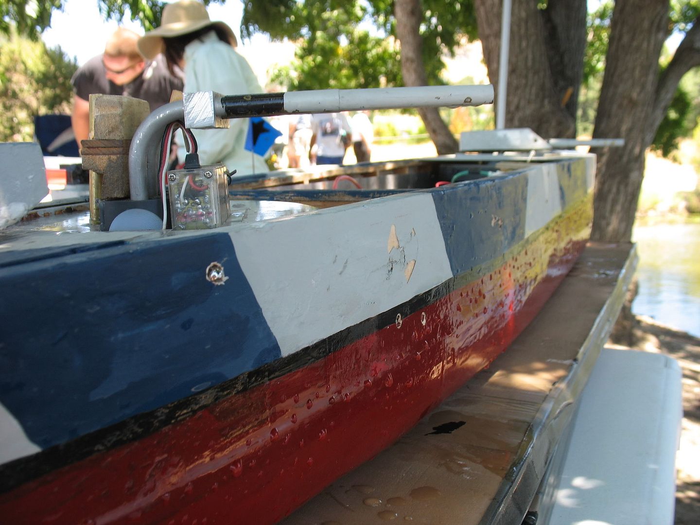

    Most cannons use flexible tubing as the joint between the barrel riser and the barrel. This works pretty well, but isn't perfect. The tubing doesn't like being bent, and the more you depress the guns, the more torque your servo requires. The rolling bar depression system replaces that flexible rubber tubing with a cylinder that rotates along the axis of depression. The barrel is stuck in the top, the bottom has an adapter to receive fast-moving shots from the riser, and and the whole system requires very little torque to go from horizontal to max depression. The downside is that manufacturing the rolling-bar depression system takes machine tools and a lot of skill, which is why most skippers use the rubber tubing system, instead.
    Here is a photo of the mechanism:
    The "rolling bar" is the white plastic cylinder, held in place by the gray PVC block. The barrels go into it, and the the entire system rotates smoothly around that axis of rotation. This is a basic example, but more advanced versions (and much more compact versions) move the rolling bar up and forward, so the axis of rotation is after the bend in the barrel. This allows a MUCH greater depression, but is extremely difficult to produce and can only be done on the largest battleship turrets.
