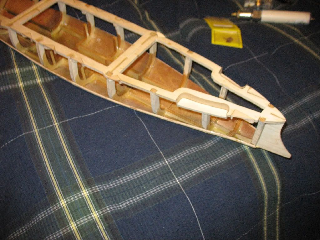

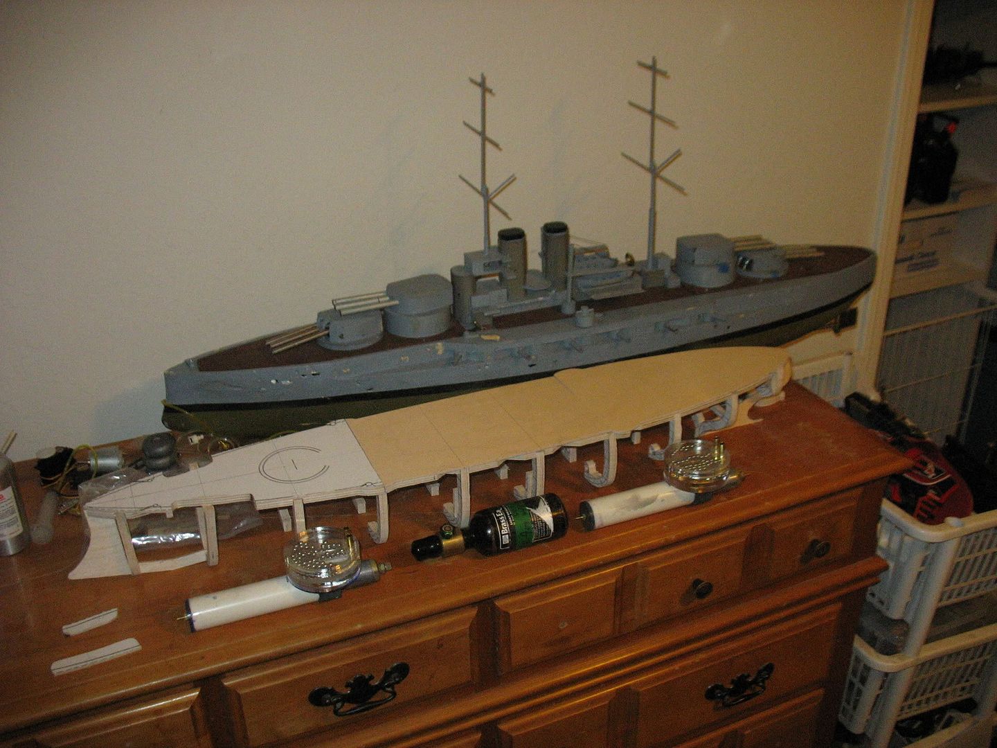

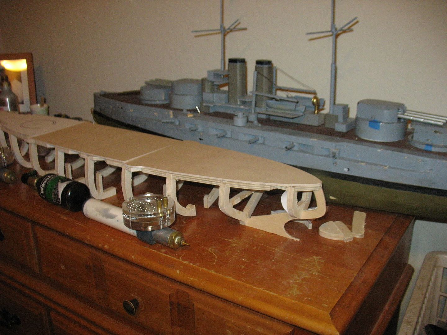

    After a marathon 7-hour-long wood-cutting spree, the Imperial Japanese Navy's sixth 1st-rate battleship, Mikasa, was finally laid down. The Mikasa has been on my drawing board for more than two years, so when the time came to cut, I knew exactly what to do. subdecks, ribs, decks, and keels have all been cut. Below, you can see my first test-fit assembly at home, and my planned internal layout using my laser-cut cannons and a 4-oz CO2 bottle. The mighty Prinz Eugen looms large in the background, but Mikasa has a much more impressive ram bow :D
    Here's another look, this time at the stern. A few details worth noting include:
    1) cutouts where the casemates go. They are very close to the deck, and so are tricky to do in a traditional wooden hull. More details on that in a later post, probably next week.
    2) propshaft supports. I already know the exact internal layout, so I know where the shafts and motors will go, and built supports directly into the hull to ensure their alignment and strength.
    3) built-in braces, bottle/battery mount, supports for servo tray in stern. As I mentioned earlier, I've been planning this boat for a long time. With that much time, not planning these in would be embarrassing.

    I chose to use joinery not for any strength, but to make the tumblehome hull more accurate. If I had simply placed the subdeck and deck on top of the ribs, like I do with other hulls, the ship would have had a knuckle at that seam, that would have been hard to sheet. In this particular case, I oversized the subdeck and used joinery to locate the ribs, so I can sand the subdeck to exact shape later. The deck and ribs are perfectly scale, however. I'm still not a big fan of joinery on non-tumblehome ships, though, especially after yesterday. All those notches are a pain! I'm planning the Mikasa to be my showboat, to be as historically accurate as possible and to have as much detail as its bitty predreadnought hull can handle. I'll have to be careful not to overload it with shiny brasswork :eek: right now, the debate rages between doing the pre-war version with its bright colors, plentiful air vents, and huge masts, or the Tsushima-strait version with its easier-to-maintain grey and smaller masts (but more rigging, squee!)

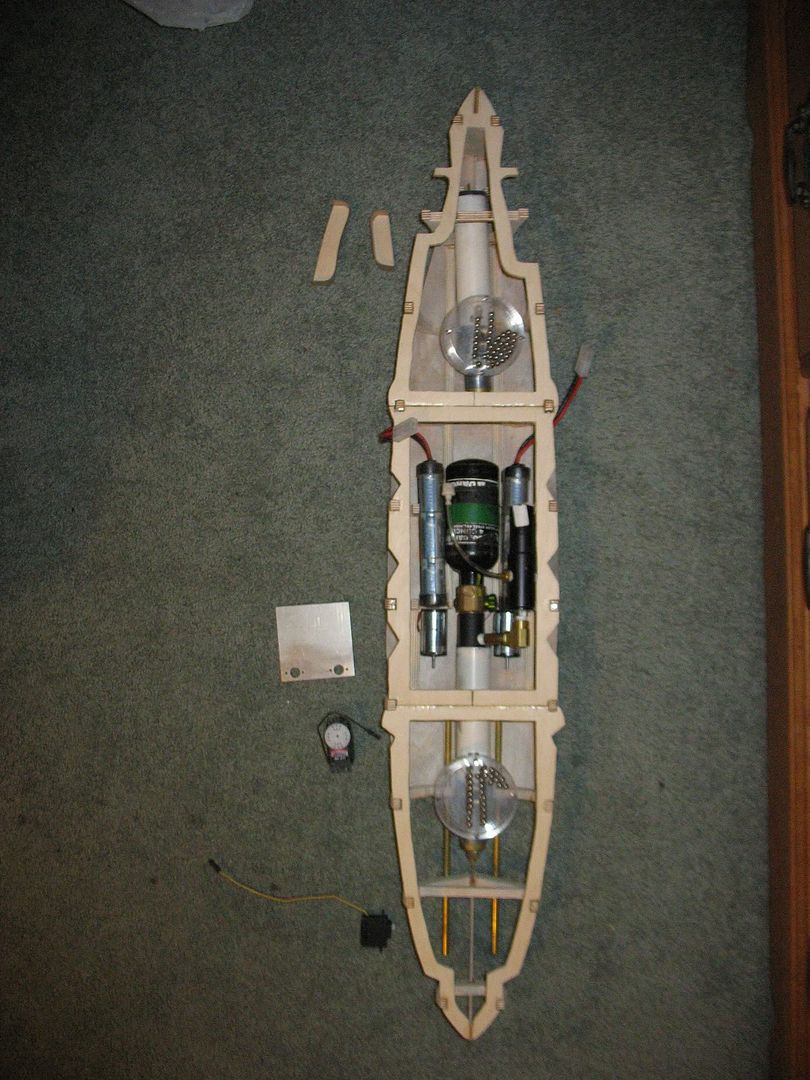

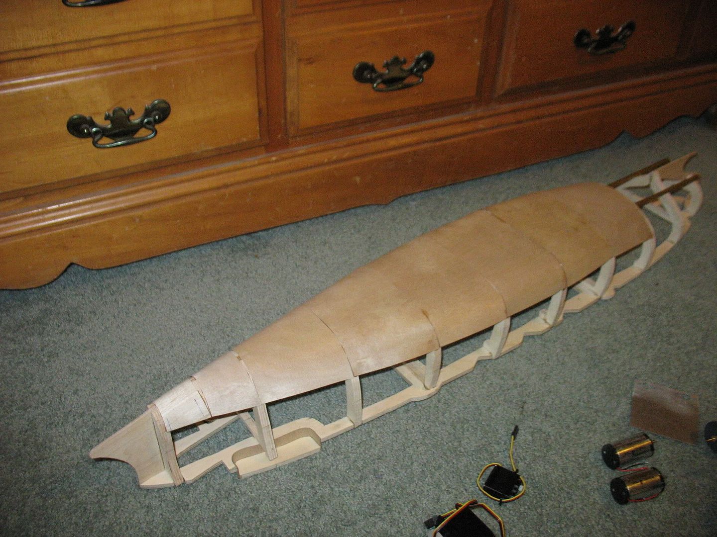

    Haven't gotten much done recently, due to efforts refitting Prinz Eugen and Tegetthoff. I'm almost done putting on the bottom, though. I am wrapping the bottom in 1/64" plywood. Once that's done I will lay down a single 3/32" plank on either side to make a no-xacto-cutting bottom edge. In the photo below, you can see my progress on the bottom. You can also see what I'm planning to do for the anchor decks. I saved the cutouts from the subdeck and deck, and wrapped a 3/4" wide strip of 1/64" plywood around them. The idea (as shown in the photo) is that I can then re-insert the pieces into the subdeck, using the strip of plywood to hang them down at the correct level, and sand to fit. Unfortunately I made a boo-boo and put the plywood on the wrong way, so they fit upside-down. I can still peel off the plywood, but I'm focusing on the bottom right now.
    Above is my planned layout, with parts placed in approximately correct locations. In the very bow you can see the front gun, with accumulator going forward. After fiberglassing the bottom, I will need to knock out the bottom of the rib there, so I can fit the gun in lower. Lower guns means longer barrels (thus more efficient), and room for a depression servo. That's right, I'm planning this little baby to have both rotation and depression.
    Next you can see the batteries and CO2 bottle. Right now I have a compact 4oz bottle there, but there is room for larger. I hope to test-fit a 5oz and a 7oz next week, and I'll take whatever fits. The batteries are standard RC car packs, and they go on either side. The batteries hold the bottle centered in the boat, and the bottle keeps the batteries from shifting. This whole center area almost snaps together, it's such a nice fit. No worries about shifting ballast here.
    Just aft of the batteries are the shiny objec... I mean motors. One pair of high-efficiency, high-performance maxon A-Max motors in shiny silver cases. These two babies will move my ship at speed for less than 2 amps, and plenty of torque to go with it. Hopefully they'll get me up to speed for less than 1 amp. Between the motors (and underneath the end of the CO2 bottle) is the pump. I don't have it yet, but I can actually fit a BC small pump there. The only question is brushed or brushless, and I won't decide that until the next Naval Budget Review.
    Finally there is the stern gun and stuffing tubes. As with the front gun, the back gun will be as low in the boat as possible in order to fit longer barrels and a depression servo. This one is extra-important, because it is my anti-torpedoboat gun. If any cruisers or destroyers decides to get adventurous, this is what I'll use to fend them off. It'll also be my primary weapon against battleships for the first 6 months of Mikasa's career. Once they learn to fear it, of course, I'll start using my front gun more to chase them down while they run away :)

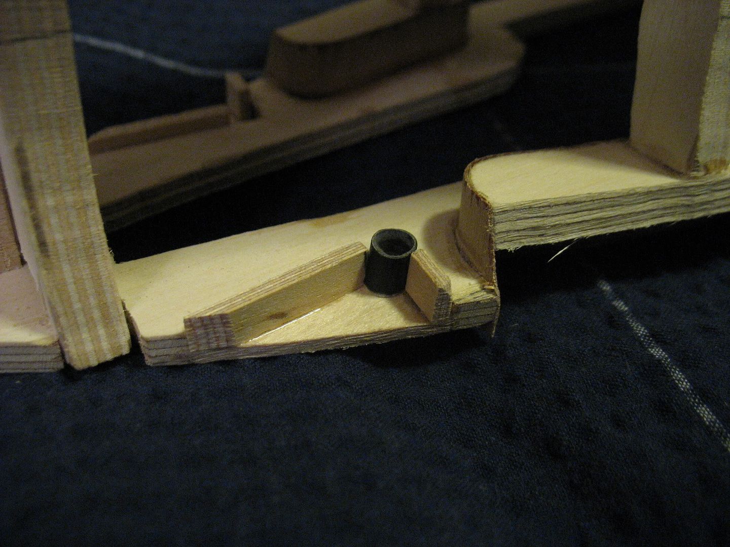

    The basic hull is already together, so I've been working on the casemate guns and started epoxying the hull. The casemates presented quite a challenge, since they are supposed to be exactly 1/4" below the deck. The deck is 1/8" thick, and the subdeck is 3/8" thick. This left two easy options: go 1/8" low and put them below the subdeck, with tech officer approval, or go 1/8" high and go directly into the subdeck. Either way would not be historically accurate, however, and I refused to accept that. Instead, I chose a third option: go into the subdeck, then lower the casemates by 1/8" so they're correct. You can see in the 1st picture that there are a number of triangles along the subdeck where the casemates go. Those are where I fitted 1/8" spacers to get the casemates down to height. You'll also notice that I added in the anchor decks. These are probably one of the most unnecessarily complex features ever put on a battleship. They don't help the anchors at all, they don't make storage or handling or deployment of the anchors at all, and they are a pain in the *** to use. However, they add to the funky predreadnought look and add extra impenetrable area, so I just had to have them. I will be filling in the accurate details later.
    With the casemates now at the correct height, I then had to build the features themselves. On the VUs, I carved them out of solid wood, then added half-round dowels to make the gun shields. These splintered and failed very easily, so this time I decided to do something much stronger. I'm using quality 1/8" ply for the angled sides, and using 1/4" fiberglass tube for the gun shields. The gun barrels will be carbon fiber. To prevent the fiberglass tube from failing spectacularly, I am planning to fill them with epoxy when I install them. The 1/8" ply has also been carefully positioned and placed so that it holds the fiberglass tube inside the barbette, preventing it from falling out in battle. You can see a clear example of how this will work in the second photo. I still need to find a better way to cut the fiberglass tube, as you can see by how horrible my test piece is. Cutting it by hand is inaccurate and irritatingly inconstant, and I've gotta make 14 identical parts. I think a mini cutoff saw plus a work stop will work, so I'll be asking around my local club if I can borrow one.
