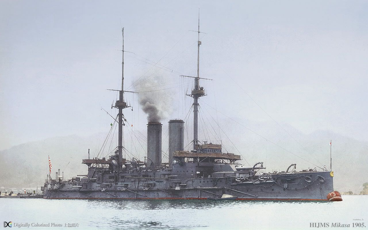

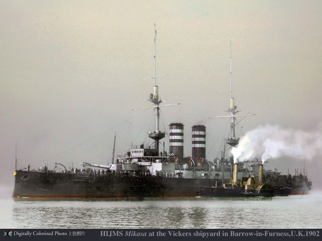

    I agree. I didn't choose this boat for its ***-kicking stats, I chose it because of how much detail I can add. The WWCC gives out an award each battle for the "most detailed ship". Whoever wins that the most times in a year gets to keep the trophy. With at least a quarter of our active members seriously competing for that trophy, it's those little things that will make the difference for me. Of course, I hope it still is an ***-kicking battleship, but with only four 7/32" guns it'll be hard to get the respect I think it deserves.
  3. Anachronus
    Well be sure and paint it up all Victorian. Didn't the IJN go for black and grey?
  4. Kotori87
    It's a tough choice. The as-built appearance (1st photo) is really cool, but she was modified and repainted for the RJW. The 2nd photo is how she looked during Tsushima. It's not as interesting, but those are the colors she wore when it was time to kick butt and take names. Tough decision, tough decision.

    I like the first one the best but thats me.

    Definitely the first. I love the way the masts are black (?) up to the fighting tops. However the light grey-green is the more historically significant.

    First one for sure. Way cooler looking, even if it's peacetime colors.

    I, to love the first picture. The multiple colors just scream out attention and detail. It's why I loved to model german armor. The multi colored scemes where attention getters.
