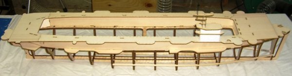

    What exactly comes with this kit?
  12. rcengr
    The Bogue CVE kit comes with the 1/4" plywood parts to make a 1:144 hull and 1/8" lite ply for the hanger deck and tower. To complete the hull you will need 1/32 plywood for sheeting, 1/8"x1/4" stringers, and balsa to fill in the bow and stern. And add all the internals to outfit it. Below is what you basically get, without the stringer and with a wood instead of a foam tower.[​IMG]
    I'm not sure what kind of armament a Bogue gets in Big Gun, it only gets one gun for Treaty. Disadvantages of the Bogue: it's slow, turns slow, and is lightly armed. Advantages of the Bogue: Lots of room and weight to work with, making it easy for the beginner to build. I take my Bogue to displays, and there is so much interior room that I usually put all my parts, tools, and extras inside so I only have to make one trip!
