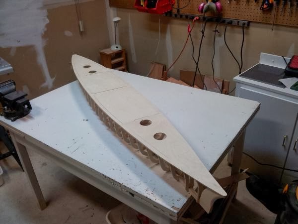

    Work on the deck mostly completed today! woot!

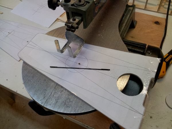

    Started as usual with some part cutting
    Which granted me some flimsy looking deck rim
    But those look so nice when set along the deck plates
    Tested the old saying: You canp>
    But in the end, the rsult was worth the delay!
    I also integrated in the deck a "Key" system to keep the deck plate aligned and secured in place. a piece of wood, same thickness as the deck plate or deck rim is glued in the center of the ship, at the boundary between 2 deck plates. Those key will be completely hidden by the SS when this one will be done!
    Next step: Filling the water channel

    I like your Key design idea, very Pro.
    What do you have in mine for the deck holddowns?
    And again, that is goregous!

    Awesome work! Inspirational. Do you have trouble breaking scroll saw blades? I seem to do that a lot. Not sure if they are too tight or too loose. Keep the pics coming.

    Probably too tight. If they are too loose they tend to fall off, atleast, that is my experience...
  10. NickMyers
    Same here. Too tight and feed too fast or ask the blade to make a radius it cant are how I snap them.
    Daniel, you have got one steady hand there on the scroll saw. Your build looks really good.

    Captkonig:
    No, I do not have issues with my blades breaking (Except a whole pack of 5 a few weeks ago. They all broke at the same place, all within 2 minutes of being put to use. I blame the manufacturer for those).
    I think that blades can break if they are too tight too lose, move too fast or move too much side way (Or of course plain old wear through)
    I learned how to not move too fast and control my side movement. Using a finger as a guide while using the other hand to push help this. Some people push with their two hands at once: I feel that this remove part of the control on the piece, and much prefer to use a single hand for the pushing motion.
    Reagarding the tightening of the blade, I use a simple trick: I try to attain the right "note":cool:. I use my nail to pinch the blade as a guitar string while "tuning" my saw! (No I can't tell yo uif its a C flat or any other, I am not THAT musically inclined), but still I know which sound I am looking for, and adjust the tension until I hear it clearly.
