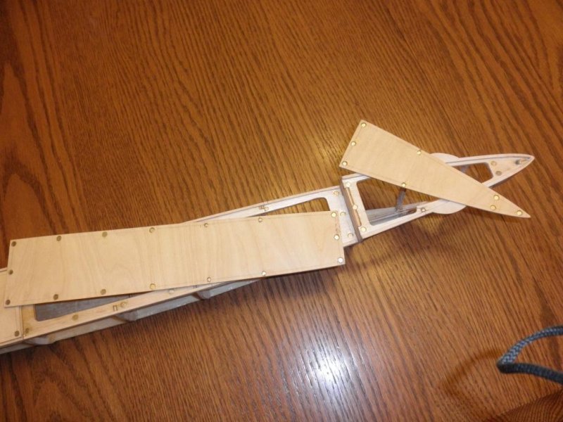

    I am a huge fan of the rare earth magnets to hold the deck down. I have used them on two ships so far (one with 1/8" deck, the other with 1/16" thick deck) and they work awesome. Use one in the deck and another in the sub deck so they attract to one another. That way they provide plenty of pull. You can get about any thickness/ diameter you want on eBay for real cheap. The ones I used in Uritski are 1mm (about . 040") thick, and held in with epoxy. You want the more flexible direction of the plywood to run lengthwise on the deck so it conforms better.
    Pics of Uritskis deck showing the multitude of magnets:

    My method to install the magnets is to clamp the deck exactly where you want it, then drill through both the deck and the sub deck with a drill bit (I use a Brad point) just a hair smaller than the magnet. This provides perfect alignment and since the magnets in the deck and sub deck attract each other, they also hold the deck perfectly aligned where it was clamped when all the holes were drilled, and they hold on like bulldogs.

    I think the magnets were only 4mm diameter by 1mm thick, but they are plenty strong. Problem on this ship is that the deck is only 1/16" thick, and it's a super small ship. I initially used about half as many , but I wasn't happy with how the deck flexed and didn't fit tight in between the magnets, so I added more to pull the thin deck down tight, I wanted a really good seal to help keep water out when the decks were awash.
    If you were trying to simply hold the deck on, far fewer magnets would certainly suffice.

    Exactly.... It all depends on what you are after. Another way to keep the decks nice and flat is to install the magnets, then apply a layer of fiberglass to the bottom of the deck. While the glass is still wet, place waxed paper on it, then put it in place allowing the magnets to hold it, but also place a ton of clamps around it to force it to fit perfectly. Then when the glass is hard and the clamps are removed the fiberglass will hold the deck nicely in the shape it needs to be, so all the magnets will have to do is hold it down. Works great as long as the decks were reasonably flat to start with.
    I like the magnets because they are totally concealed after install, but hold great. I try to use the largest ones I can fit in the alloted space and thickness within reason. Too big and you will have a hard time getting the decks off.
