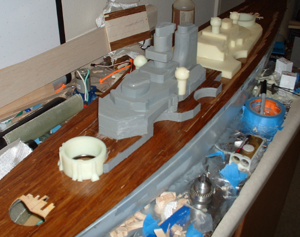

    Greg had planked the decks of his Tirpitz.. .... Looked awesome. Justin had wound up with that ship at one point....I wonder if anyone knows of the whereabouts of that ship at this point?
  6. jstod
    Was it actually planked or made to look planked?
  7. Cannonman
    Apr 9, 2008
    879
    Hermitage, Tn
    I can't say for sure, but I always assumed it was truly planked.
  8. jstod
    ooo pretty!! Im gonna go ahead and say that is truly planked based on the area around A turret.
    For a second there I thought the ship was sitting on top of an ice bath with all his supplies floating haha
  9. NickMyers
    Greg actually planked it. There are some shots somewhere that are more 'in progress'
