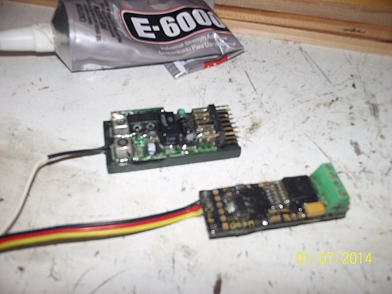

  3. SteveT44
    I use E6000 adhesive to coat my electronics.
