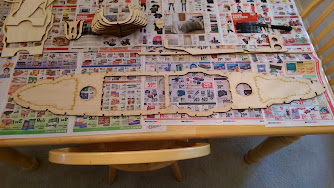

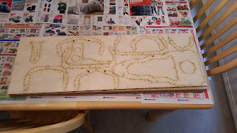

    Part 1. Things arive.
    A nice little supprise was waiting at home yesterday.

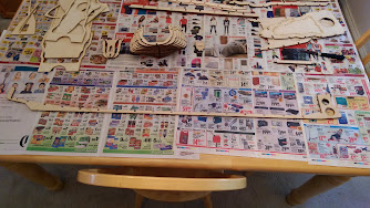

    The kit from RCENG had arived. Let me say that it is very nice. Given that I havent done more then test fit, I cant say much about it but it definetly makes me feel more comfortable with the process. A short while later...
    All the parts are out. Some very minor sanding needed in order to clean up a few of the spots where parts seperated from the sheets. Not a big deal.
    Of course the first thing one must do is lay the keel. Fits together great.
    The sub-deck also fits together quite nicely.
    I desided it was a good idea to test-fit everything so when I get to glueing I know how it all fits. The parts went together nice and easy. It is a very good looking kit. I am going to be waiting until I get the rest of the parts from Strike until I start gluing things in place as it will be much easier to remove the built in motor mounts if nessisary.

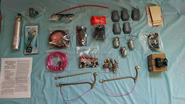

    Well I had a most plesent supprise waiting for me at home.

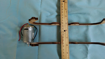

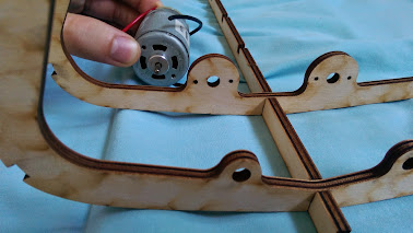

    All of the parts from Strike have arived. Now I can get to assembleing the hull, as I can make sure things fit. On that front, I have a question about the drive shaft mounts. The kit includes a set of mounts for motors built into Rib 12, however the ones I have are not going to fit at all. There are pre-made shaft holes in Rib 13 that I do want to use. Pictures below.
    [​IMG][​IMG]
    So I have a few opptions here. The first is the cut the mounts in rib 12 off and use gears to get power to the shafts. Second is to keep the mounts in place and try to fenegal the motors into a place where I can do direct drive. The third option would to go find some motors that do fit, and keep the two I have now as backup pump motors. I want to make a call on this before I glue the hull frame together as it will most likely be a royal PITA to modify the mounts on rib 12 after then. Any advice?
  9. rcengr
    Is it just the spacing of the holes that are the problem? You can enlarge the center hole to fit the boss of the motor and then drill a new set of mounting holes. The holes provided are 19mm, but if those are 380 motors I think you need 16mm holes. With the motor mounted on the bow side of rib 12 you will have room for the U-joints between the ribs.

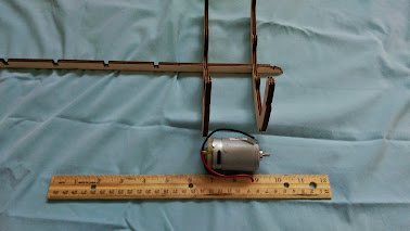

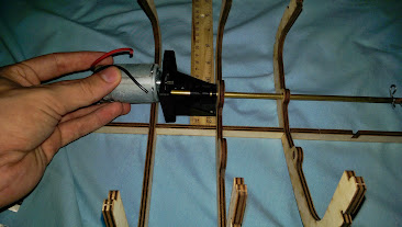

    On further inspection of what I have, some mounts did come with the kit. It looks like they will fit between ribs 11 and 12. The mounts appear to be ment for doing a geared drive to allow a direct run to the prop shafts. I can use the Picture of what Im talking about.
    Does this look like its going to work, or am I using the parts totaly wrong?
  11. irnuke
    I think you're meant to mount the motor where you have the gearbox. Coupler (direct drive) goes between the two ribs at right in the pic. Shortens the driveline by 1 rib compared to what you've got in pic.
    In your "pleasant surprise" post, the right side pic shows the rib w/ 3 holes for the motor mount. Two small outer ones are for mounting screws into the motor, while the driveshaft pokes thru the middle one. If the middle hole is too small for the bearing mount moulded into the front of the motor can, use a drill bit to widen the hole to the correct diameter.
    If you do choose to go geared drive, mount it where you've got it in the pic. Your drivetrain will be a bit longer, but you'll have more torque available.

    Ah, I see how the built in mounts are supposed to work now. With a choice, geared or Direct. Best to sleep on it I think

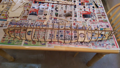

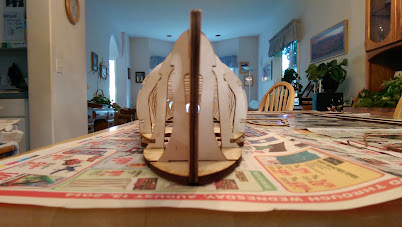

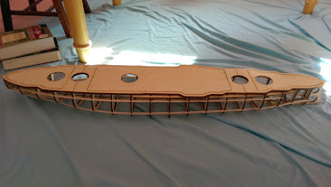

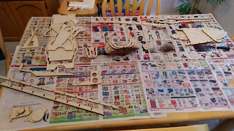

    There was productivity this weekend. I got the hull mostly put together. Didn't take lots of pictures tho, sort of got in the zone. Here is how things are looking now.
    Now, just to get blocks for the hull and material for sheeting the bottom. Then more progress can be made!
