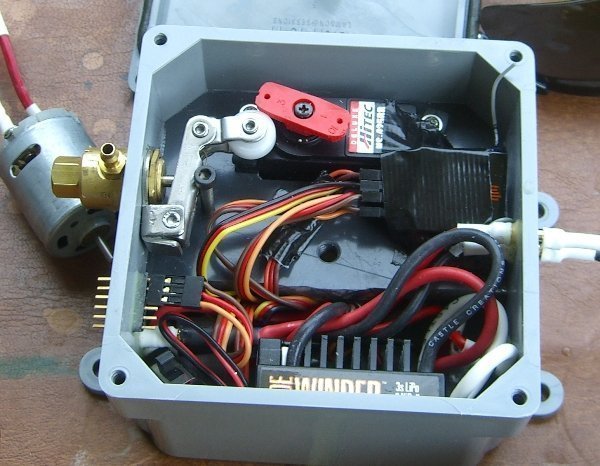

    What does it cost for a junction box? I like the setup .
  3. rcengr
    The junction box costs about $8
  4. rcengr
    In between combat today I finished populating the WTB. Unfortunately the receiver I used had a dead throttle channel. I was able to mix the throttle to the unused aileron channel and get around the problem, but now I don't have an extra channel for the gun elevate. The valve servo in the WTB is modified to continuously rotate, providing a shot every 0.5 seconds to comply with Treaty rules. Gun tests were very successful, although I need to narrow the servo arm so that the actuation period is shorter - too much blow through with each shot. Here's an interior shot of the WTB in its final form.

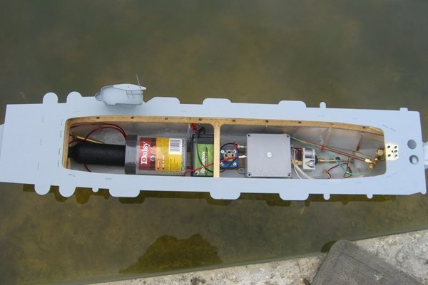

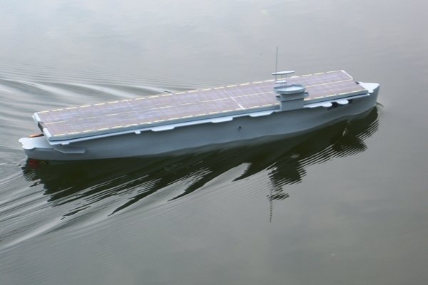

    I finally got the Bogue on the water for speed trials this afternoon. The first run was made with it very light, just to see if the motor and rudder were functioning OK. It ran like a speed boat. I had re-worked the motor mount last night because the drive dog was making a lot of noise. With a better angle between the motor and the shaft it was much quieter. After battling was done, I took it out again and added some ballast to get the proper waterline. I had fun playing around with it once I had the speed dialed in - but it handles like a loaded cargo ship: it doesn't turn sharply, and it takes some space to stop. Except for the field expedient deck hold downs, it looks great in the water.
    Tonight I'll work on getting it ready for combat tomorrow, and then later on I'll pretty it up and add the sponsons and the rest of the details. Oh, the ballast needed to get the right waterline? About 4.5 lbs, or one unopened container of 6000 BBs!

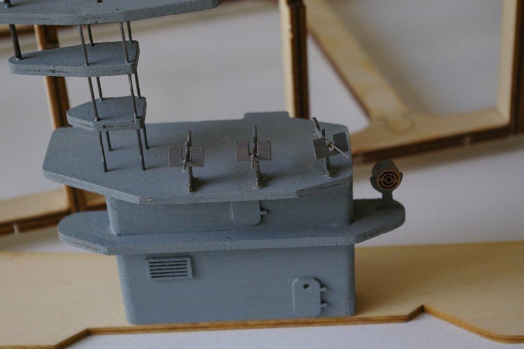

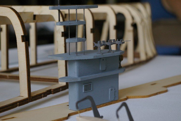

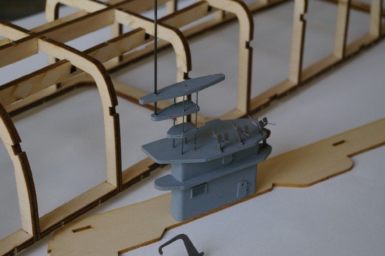

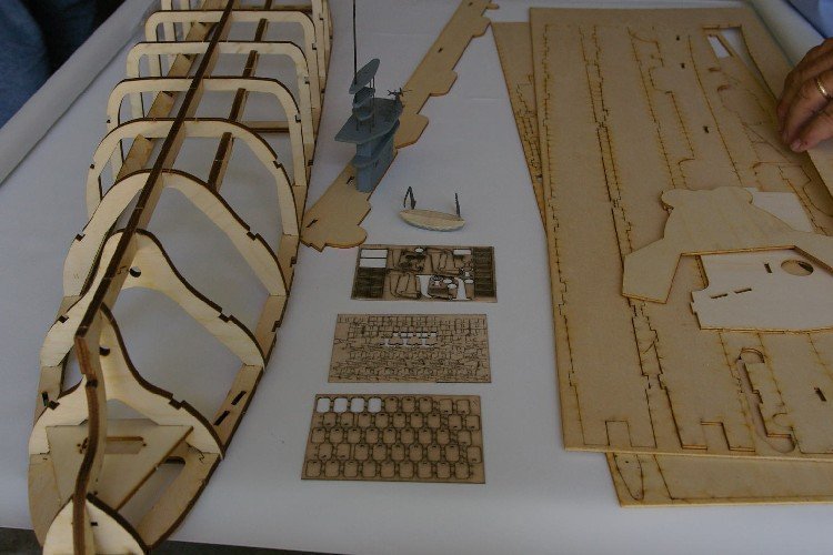

  11. NickMyers

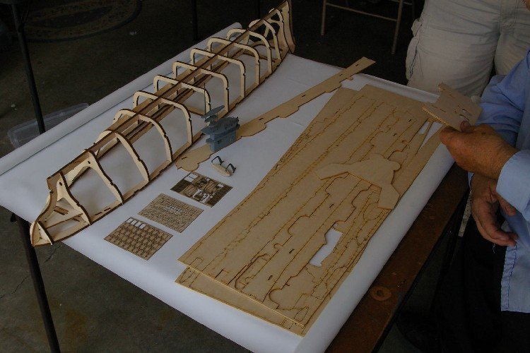

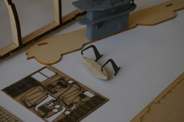

    Holy sh**!! That is above and beyond awesome. Will those come with the kit or will they be an additional add-in?
  12. Kotori87
    Holy sheet of plywood, batman! That is incredible!
    Out of curiousity, is there any chance you might do a laser-cut C3 kit? I know they share the same basic hull as the Bogue.

    Wow.... Just wow....
    Ok, I will need to get me one of those. How much does it cost to have a kit like that laser cut anyway?
  14. rcengr

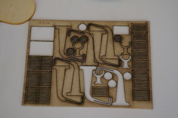

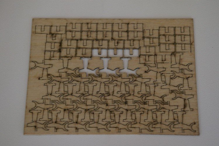

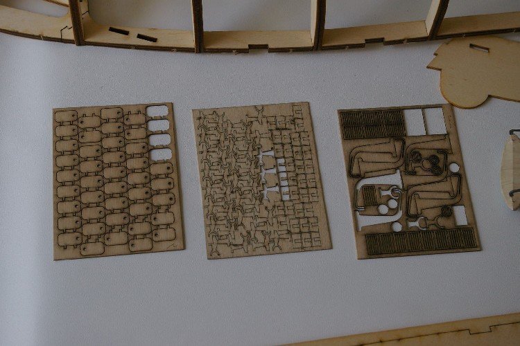

    I have not got a final price on the carrier yet, but should have one soon since I have ordered the first set of kits. I expect the kit to be less than $100, more than $60. I'll set the final price when I get the kits and the bill from the laser cutter.
    The accessories will be available separately from the carrier kit for less than $10 each. The door card has something like 45 doors, there are 36 20mm guns to a card, and the last card has 4 36" searchlights, 4 boat davits, 5 large vents and 9 small vents. These are also on order and I hope to have them by the end of the week.
    i don't know anything about the C3, so I'll have to do some research and get back to you.
  15. rcengr
    OK, it looks like the kit will cover any of the carriers based on the C3 hull, even the HMS Archer which looks like the first one. I do not plan to redo the flight deck to make an earlier version, since the flight deck took most of the design time and initiated most the headaches I had to deal with. However, I think it would be fairly easy to modify the kit to open up the hanger deck and build a different configuration.
    In addition to the other American built escort carriers, there is a French carrier with the same hull, and the hull can also be used to build most ships that used the C3 hull (492' OA, ~465' WL x 70' wide), including some seaplane tenders and T3 tankers. I found a picture of a seaplane carrier with what looks like a Mars flying boat on the back that got me thinking I may want to make a different version myself...
    I may have to offer the hull as a separate kit.:)
    What are you using for the body of the searchlights? Looks very nice!
  17. rcengr
    I made the body in the picture from a Burger King straw so that I could insert LEDs inside. For a standard searchlight, a 1/4" dowel will work great.

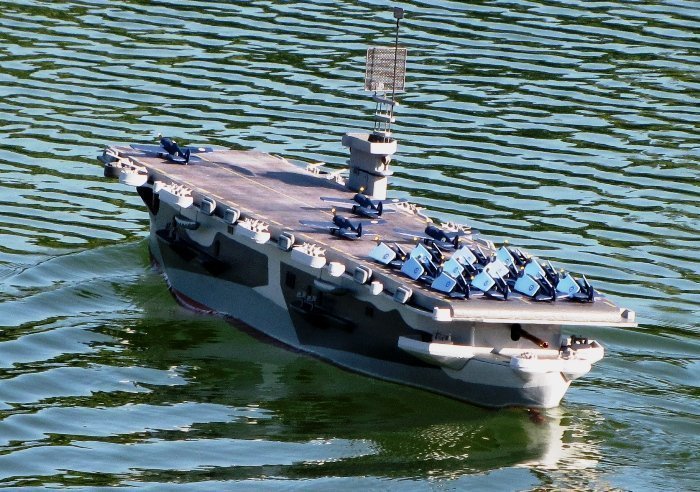

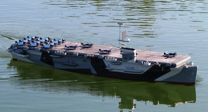

    The HMS Queen left the dry dock today after completing fitting out. With a squadron of new Grumman Wildcats on board, the shakedown cruise was successfully completed. The crew is looking forward to their deployment in the Med.:cool:

    Mark, that is almost too pretty to shoot at. Almost :)
