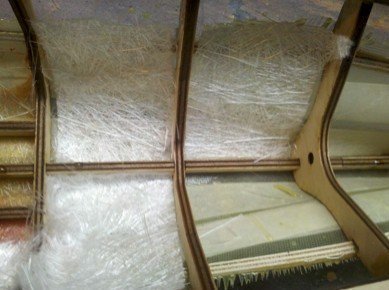

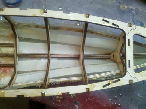

    In an effort to further expedite the building process, I experimented with using masking tape instead of 1/32" plywood or basswood strips for the hull bottom and impenetrable area. I turned the hull upside down and ran 1" masking tape from station to station to define the hull shape than glassed over the tape with fiberglass cloth and West System.
    To further reinforce the hull, I cut fiberglass matt to shape to fill the gaps between stations and glassed them in from the inside. It all resulted in much faster hull construction than I'm used to.

    Inventive.
    Another thought is to use 1/16" X 1/4" basswood strips (instead of the masking tape) spaced apart to build a more fair lath to drape the glass cloth over.
    Steve

    But it's not at all faceted. If you look closely at the pictures, the tape is secured to each station and so assumes the curve of the hull. This method provided a smoother hull in fewer steps so far.
    In the past I have used basswood or scrap wood cut to fit, but that adds CA or tiny nails to the equation and several additional hours. Seeing wood through clear resin is prettier on a warship, but for a convoy that'll only get cracked once a year at Nats, I'm happy.
    Remember, campaign is about volume ;-)
  16. SteveT44
    I removed the faceted remark from my last post after looking at it more closely. I'd thought it might be faceted from frame to frame.
    I'd like to see a shot down the length of the hull when completed.
