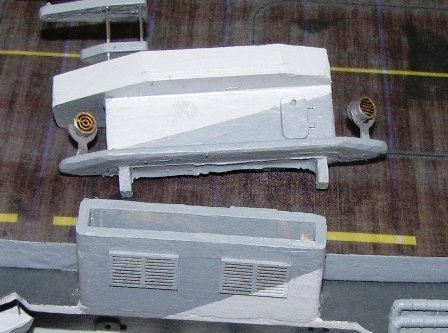

    Yes, you can make the tower into a float. Below you can see how I did mine. With the tower removable, it is also easier to transport. [​IMG]

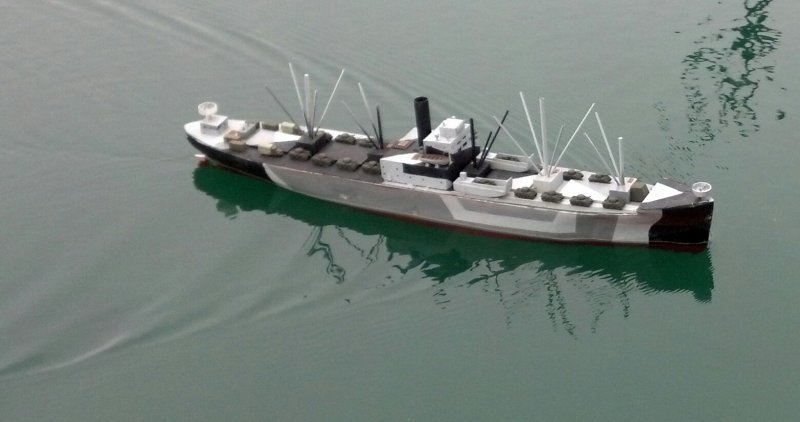

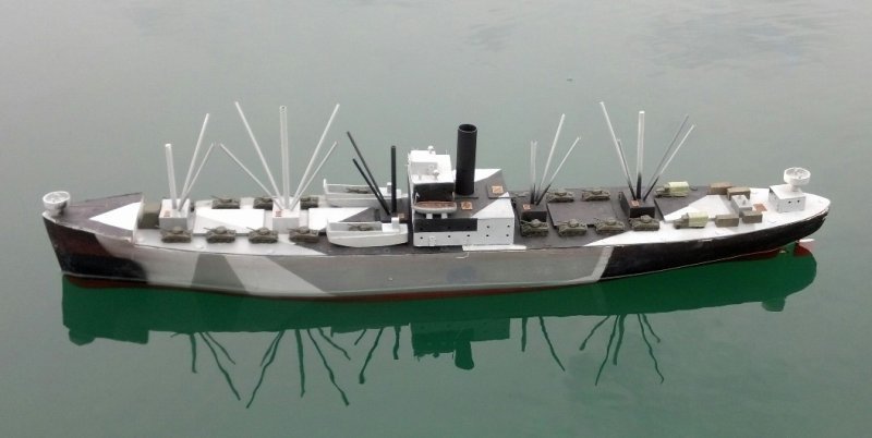

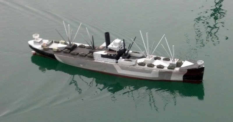

  4. Jacky Fisher
    Jacky Fisher Member
    Jun 6, 2008
    43
    I'm turning mine into Empire Widgeon for convoy duty. I've discovered that with a complete superstructure, all internals, and a 12ah SLA, the water line is just about where the penetrable area ends so I'm going to have to remove a lot of fiberglass to give it 1" penetrable below the waterline.
    The penetrable area which results from the kit as built is probably perfect for combat ships carrying much more weight, but I want buoyancy so am running it light. Still very pleased. I'll try to post pictures soon.
  5. Jacky Fisher
    Jacky Fisher Member
    Jun 6, 2008
    43
    Here's how Empire Widgeon turned out.[​IMG][​IMG][​IMG]
