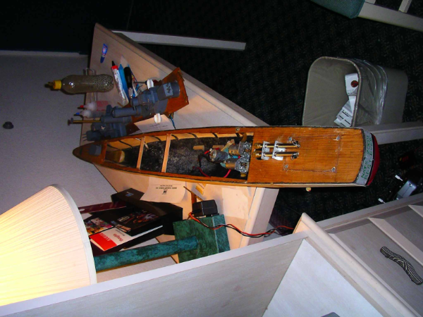

    here is the interior, from NATS_06 I built it so pretty much everything comes out easy. not much in the way of water channeling but I cant say I ever took enough damage to really need it.
    6V 5 Ah batteries, never had power issues.
    3.5oz CO2 bottle with a Palmer regulator.
    BC pump
    She was built originally with poppets and such but has since been rebuilt/upgraded numerous times and now has all the "modern" trimmings like Solenoids, TD boards, and expansion tanks.
    Nice setup.

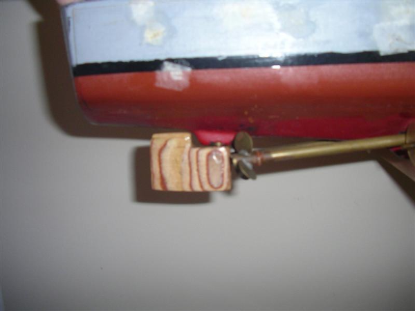

  5. SnipeHunter
    Thanks guys.

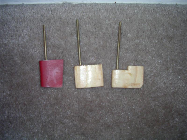

    Here is the pic of the rudder on my Brooklyn, the second pic is the evolution of the Brooklyn's rudder. The first is a stock swampy class 3 rudder, then the next two are modifications showing how I got to the final design which you see in the first picture.

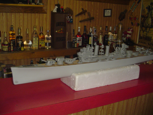

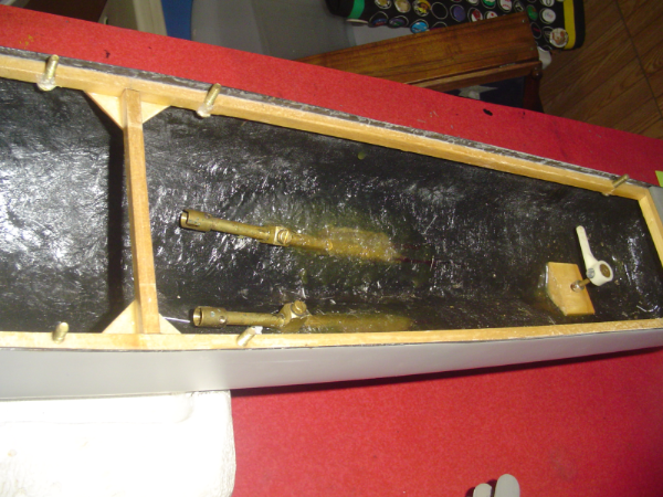

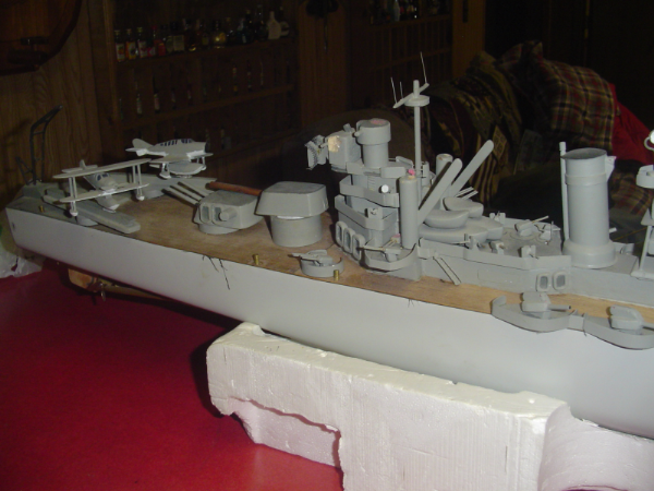

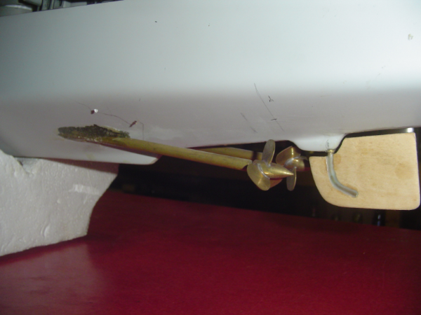

    Thanks looks great will post pic of what I have so far in the morning. The supper structure was already done. I will make a second because the one it came with is to nice to battle with
