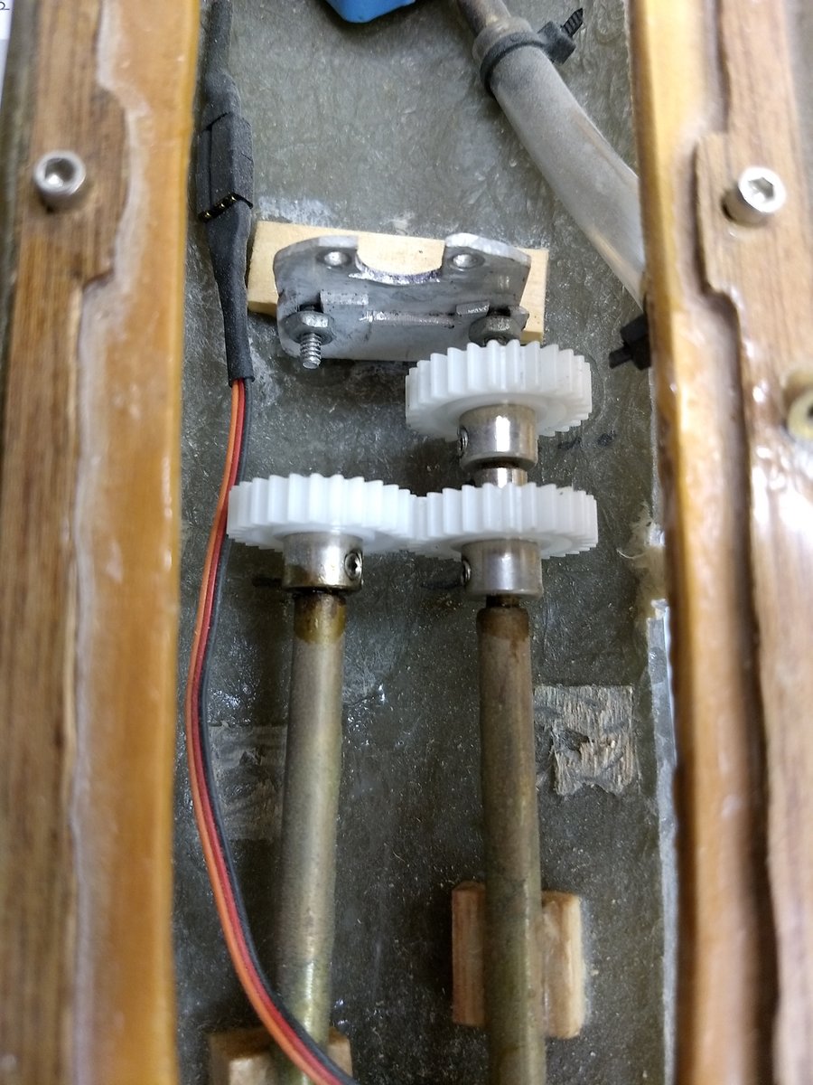

    This may or maynot work in your case but on the off chance it's helpful it's a different approach to solving that problem.
    One motor, two counter rotating shafts, it's not a prefect solution but it does save some weight only needing one motor.

    This layout is genius! Super space efficient
