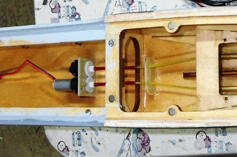

    How did you drive offset motors to the props?
  9. rcengr
    The shafts driving the props are flexable - 1/16" steel cable from an R/C airplane flexable pushrod. The outer yellow sleeve keeps the flex shaft from moving anywhere and the cable easily bends though the curve. The gearbox and flex shafts are joined with some 1/16" ID Clippard tubing. Because the counter-rotation is done at the gearbox, torque on the motor and gearbox balances nicely to zero - the motor and gearbox are not actually mounted to anything, they just rest on the bottom of the boat.
