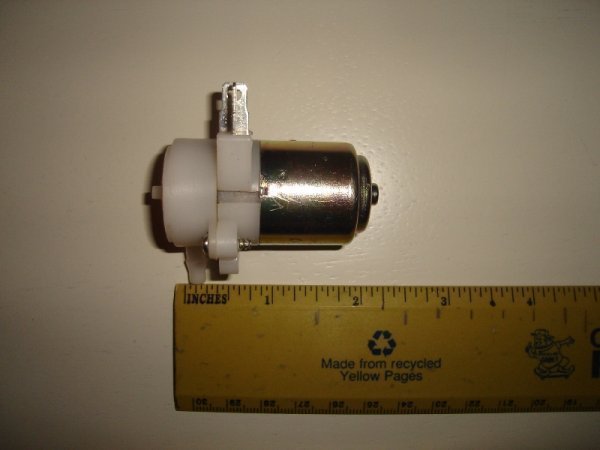

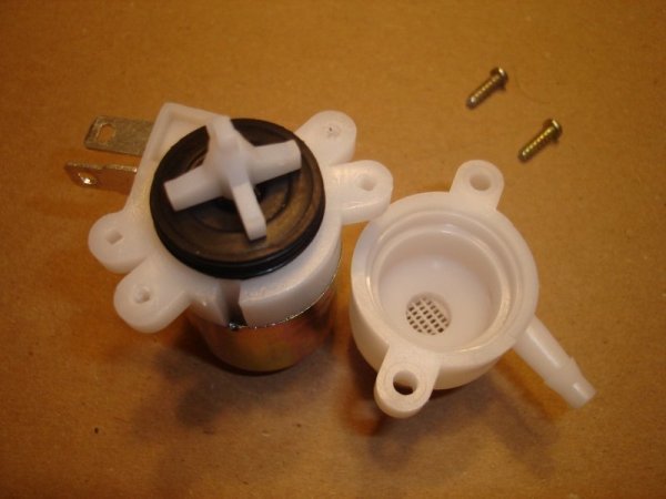

  14. absolutek
    What motor is that?
  15. Beaver
  16. Beaver
    Did a flow test today. At 7.6v I got 1 gallon in 1 min 13 seconds, or .82 gpm. Does that sound good for a 1/2 unit pump 3/4" two bladed impeller?
  17. SteveT44
    My Mogador pump is pushing 1GPM at 12v so your right in the groove.
  18. Beaver
    I'll have to see what she does on 12v. Should be easy to get more than a gallon a minute. What size impeller are you running, Steve? Any idea of the RPM's?
  19. SteveT44
    I think the impeller is 3/4". Rpm's, who knows? It's a modified washer pump. FYI, monster flow rates aren't really needed with a DD. Even your measly .82 gpm will flush out a Fletcher in seconds. Make sure your pump and ESC work well at low rpm. I found on the Moggy that when I bump the pump trim up I was getting a nice little 6" stream which was keeping her afloat very nicely with several belows for an hours campaign battle without hardly any battery impact.
  20. Beaver
    Yeah, I don't really need/want a super pump, just wanted to know the max pumping capacity. Turns out that this pump/motor combo won't work at 12v. At full throttle the motor jerks like it doesn't have the torque to run it. Runs fine at 7.4v though.
