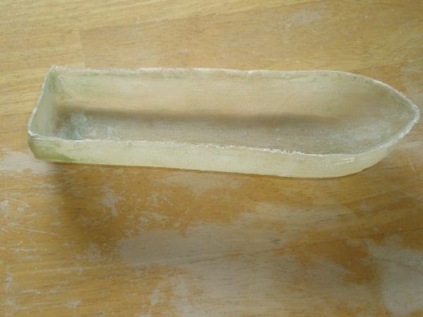

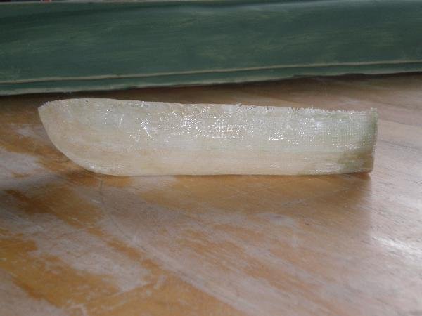

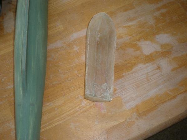

    Mostly I'm just messing around with this build for practice.
    heres some pics of how the hull came out...still need to do some sanding to get the shape quite right...let me know what you think: things I could do different? constructive critisim? advice?
    also I'm having some issues with the electronics being too heavy without the engines, prop shafts or rudders installed. when I float tested it without the electronics it floated perfectly, with the electronics it almost sank...[​IMG][​IMG][​IMG]
    Edit: Yeah its in 1/144. thnx for the help

    Most rule sets allow small ships under a certain length or weight to add additional hull height to help it stay afloat while loaded. For instance, I think MWC allows an extra 3/8" added to the hull depth. Perhaps you wcould do the same and get more displacement to hold the electronics.
  3. Kotori87
    Extra depth might help, but really what you need is ultra-light electronics. That PT boat is in 1:144 scale, right? The only person I've ever known to successfully built a 1:144 scale PT boat (not armed, just running) had years of experience with aircraft before he moved into boats. Start looking at the hardware they put in ultra-micro RC airplanes, and you'll get a better idea what you need.
