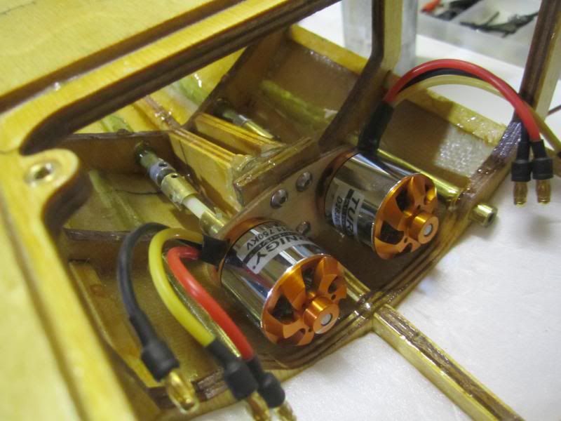

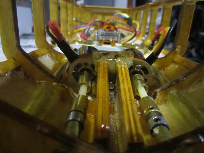

    Chicago Update
    New brushless setup. I have discovered a nifty little feature with these outrunner motors. I am useing Direct drive with dog bones. Since i removed the retaining E-clip on the shaft, the outrunner case can be pulled off the armature slightly. It is enough to slide the dogbone in without removeing the Motor mount. Score!
    I had to change the bolt hole layout on the port motor, to get the wires out of the way. The allen M3 bolts can use the same wrench i use for the 6-32 bolts.

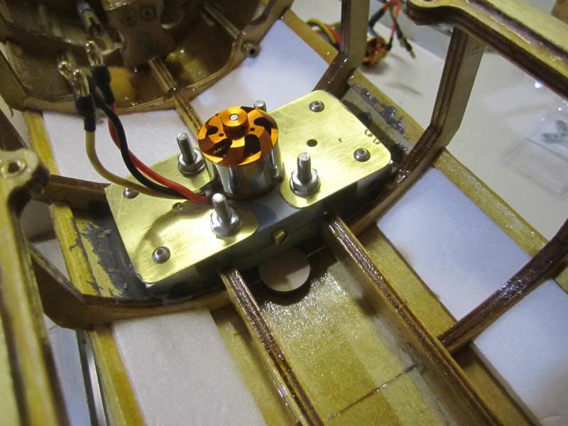

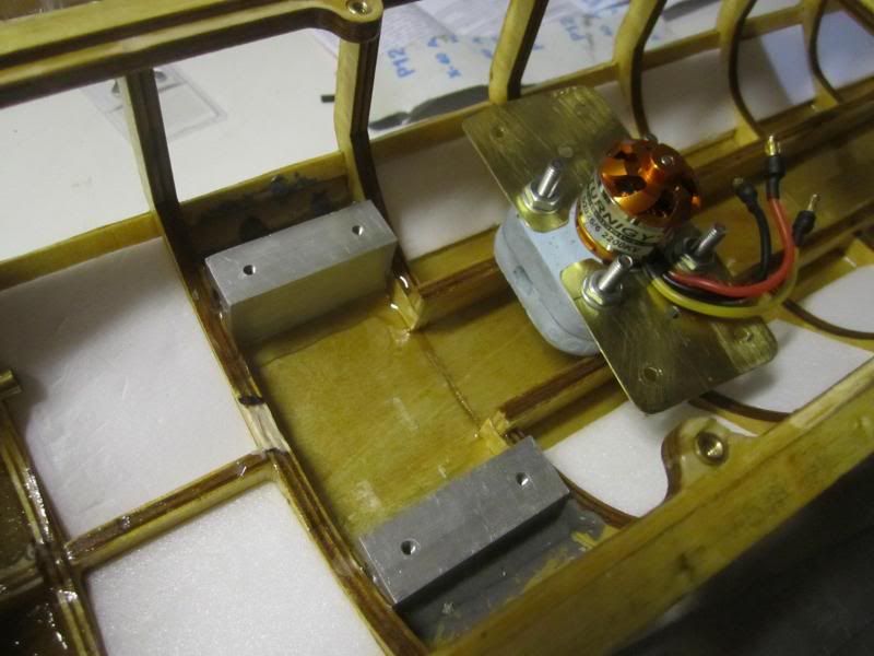

    The pump. Bought a old Large BC pump off a forum member, epoxied in the old bolt holes, epoxied/fiberglassed/Drilled the large 540 motor hole. And then redrilled and counterbored for the 380 sized motor.
    For the Mount i took aluminum bar stock, swiss chessed the inside of it, and drilled and tapped for 6-32. Using brass shim stock and the pump bolts, it is very solid. Possibly overkill :D. Plus i will be able to shim the pump up or down depending. Its a hair higher then 1/4".
    It may need a diet plan, so i will trim the bolts, drill holes and sand the brass to shape.
