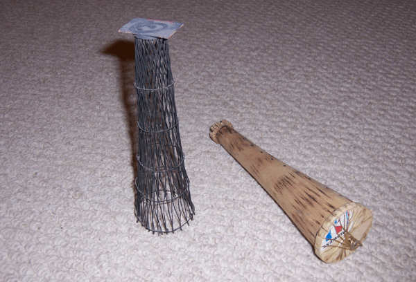

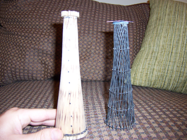

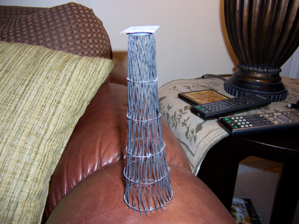

    Here's the pic's of the cage mast for the USS Mississippi pre-dred.

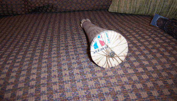

    Screw on the bottom that the wire is wrapped around.
    Top and bottom disk are removable. Cut the wires at the top and bottom, remove the disks and the balsa form falls out.
