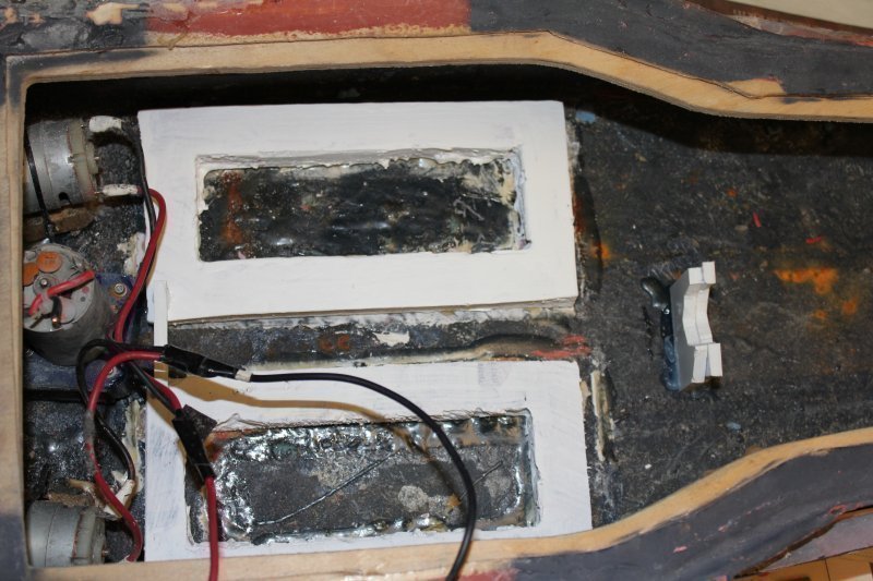

    So here are some pics of the Tennessee as it sits in construction
    [​IMG] The bottle will sit in between the batterie.
    Looks good Paul.

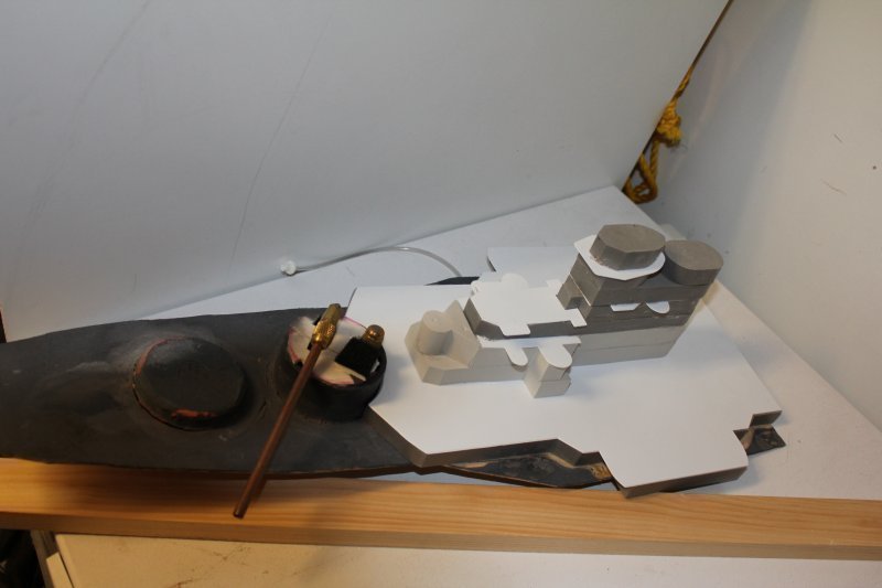

    The snap lid box was too small to use as a firing box The lid would not be able to be closed. Looked for larger snap lid box but couldnt find one. So I went and got a pvc junction box that is waterproof. The lid has a rubber gasget and screws down. I got the poppets placed. I just have to make the holders for the servos. I will need to drill one other hole for the servo extenders. Once the servos are mounted and I will goop and silicone the openings to make it water proof.

    Got the poppet valves installed in the firing box as well as the servos. servo pump switch was installed in the box. There is only one hole left to drill and that will be the servo leads for the receiver. Tommorow I will goop and silicone the poppets in place.

    Went back at the Tennessee this afternoon. The batteries and pump have been wired up. My waterproof box did not fit once I put the bottle in so I cut the box and moved the servos to different spots in the bow to make room.I just need to get some contact cement to start sheeting. Then comes the pneumatics.
