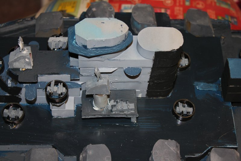

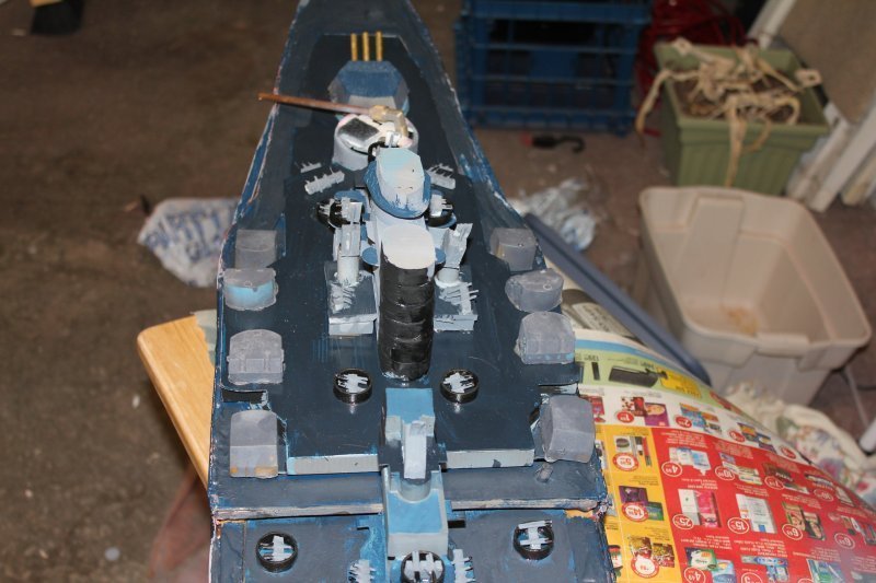

    If it is sunny tommorow then the Tennessee will go for a run. Need to water test it. I should have the gun directors and platform installed this evening.
  2. bb26
    I got the gun directors and platform installed. I am pleased with the progress.

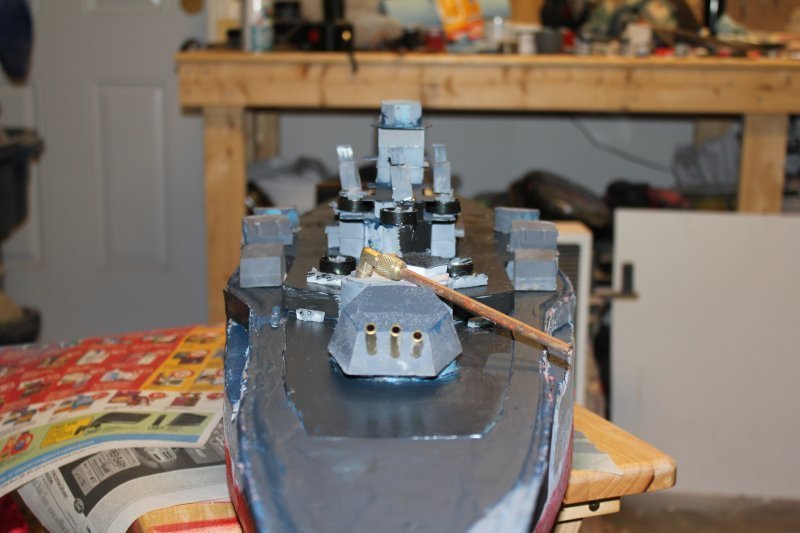

    [​IMG]another shot
    [​IMG]another
    even more
    [​IMG]one more
    [​IMG]and lastly

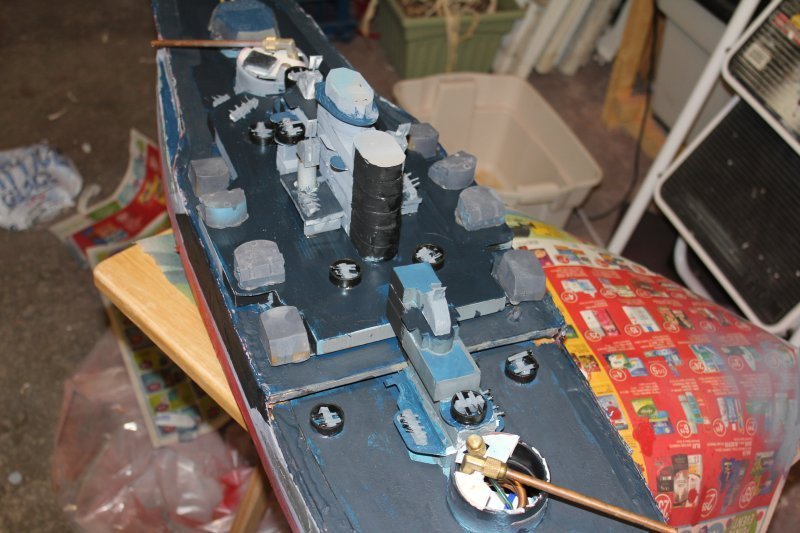

    Once the minor repairs are done I will start working on securing the turrets. Then I can finish the paint job.

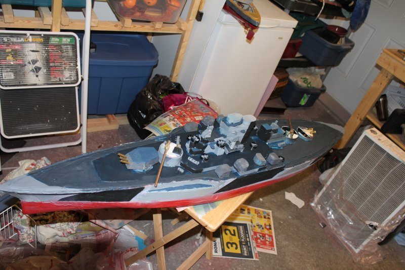

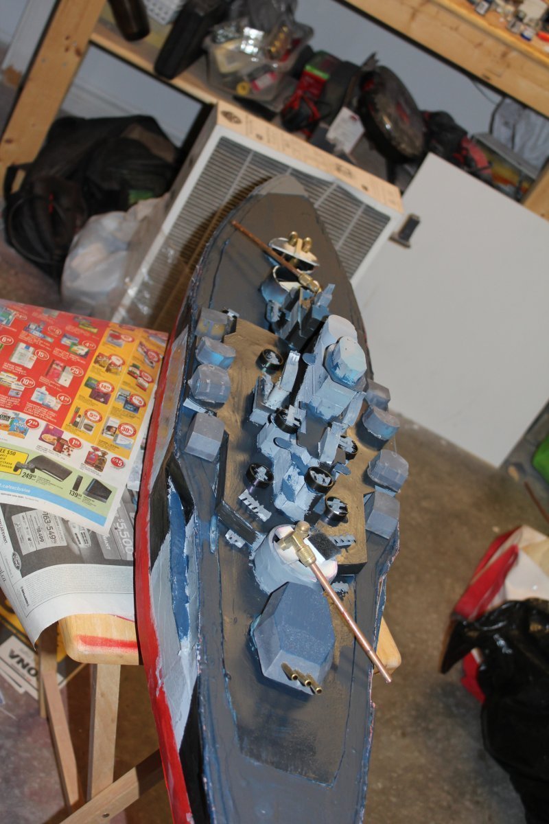

    Waterline tape was put on. Looking better. The secondaries were now added. I fixed a small issue of the back hatch not quite seating properly. Tomorrow will be turrets. Once they are done then the dummy barrels and paint.
  19. bb26
    And of course re-install the "armour". It is shower curtain and it worked well at IRCWCC NATS in 2010
