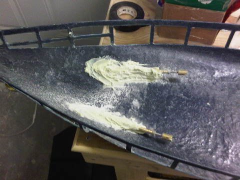

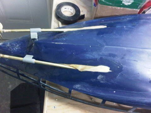

    Some more pics of the build. The shafts have been resined in.

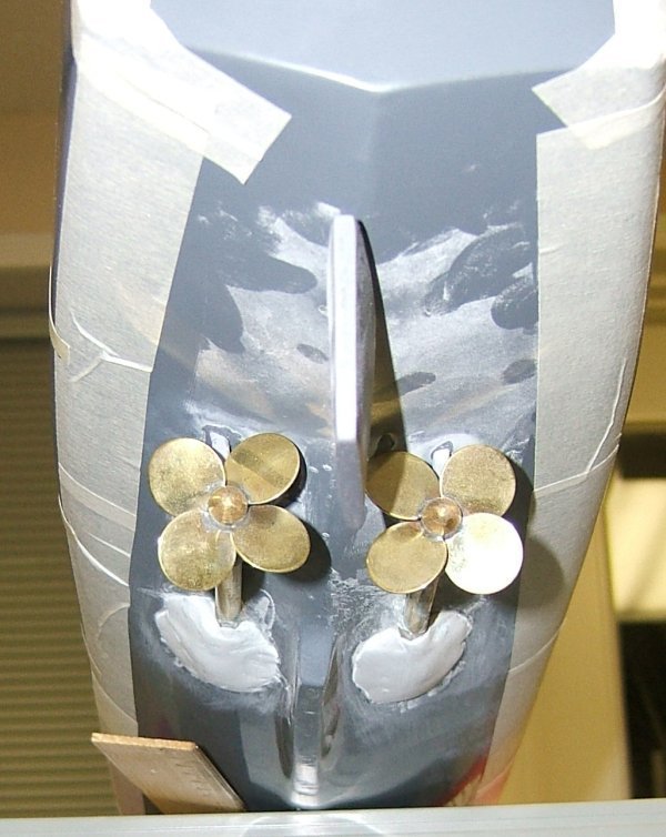

    Hey BB26 after I epoxied my stuffing tubes in I didn't like the way it looked coming out of the bottom of the hull so I went to Lowes and found an epoxy putty that gives a really smooth appearance. Granted, it doesn't add any functionality to the boat but it does look nice.[​IMG]
    so the epoxy putty is the whitish grey stuff just forward of where the stuffing tubes come out

    Next time just tape the outside of the hull and do the epoxy from the inside the tape then forms a mold for the epoxy on the outside.

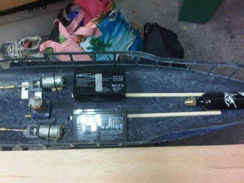

    Here are some more pics of the build. The motors are mounted. I am planning on using some foam mat as water channelling. There are some possible layout options for the battery and bottle.
  5. mike5334
    I suggest turning the bottle around and moving it back towards the batteries if possible. That way, the ship won't change trim as the bottle gets lighter during the battle.

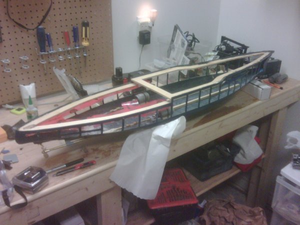

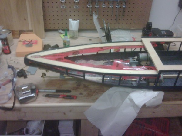

  6. bb26

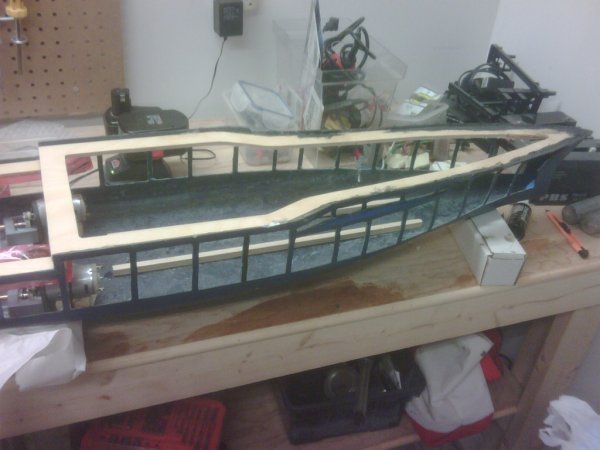

    Further update. The rear subdeck has been installed as well as the rudder post. The next step will be to install the main subdeck.
  7. bb26
    The front subdeck was attached and resined in. In a few hours it should be dry
    Good work Paul.
  9. bb26
    The sub deck is fully resinbned in. I will be using the sintra deck to make sure I have a template for when I cut the wooden deck.
    here are some pics.
