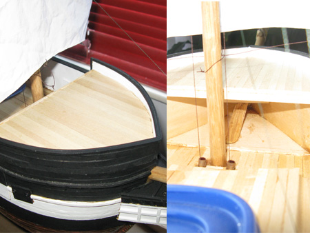

    Hello everyone. At some point in the future I'm hoping to make my hometown's namesake, the USS Indianapolis. Until then, and as a way of getting an introduction into model ship combat, I'm looking to add some type of firing cannon for my HMS Beagle. But I need some help.
    Here's what I'm thinking about, but I'm open to whatever you all think would work.
    A single cannon, with a 1 to 1 1/2 inch long barrel, to sit up on the forecastle, able to fire 1 to 6 bbs (well more likely balls of flour or fish food pellets).
    There's a 4 x 4 inch area on the forecastle to mount the actual gun from. Directly below the deck there is a 2 inch tall area for stowing a CO2 canister and other components on the main deck. And if needed there's more room below the main deck inside the hull.
    So my question is, how would you go about making a single barrel, 1 to 6 shot bb gun, that would look like an actual cannon?
    Here is the link to my HMS Beagle build log if you want to take a look: www.andrewaasmith.com/HMSBeagle/Intro.php

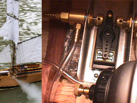

    There's a ship called the Lady Love http://bellsouthpwp.net/c/h/chrisgski/page16.htm that might have something like what I'm looking for. Here is how the builder describes it:
    "Cannons equipment is installed. After small explosion, I upgraded the plastic lines to thicker rubber lines. The mav-2 valves are from www.Swampworks.com. I later then added the talcum powder kegs between the valves and the cannons, for an awesome visual display."
    Do you recognize this setup?
  6. Kun2112
    That is a very similar setup to what Kitori is suggesting
