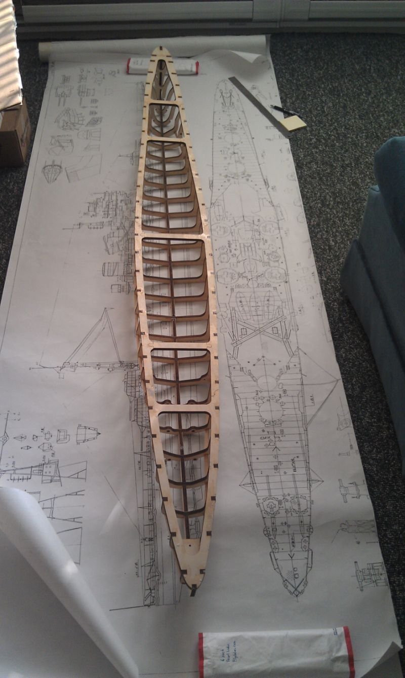

    The just-assembled hull on top of page of the scaled up Myco plans.

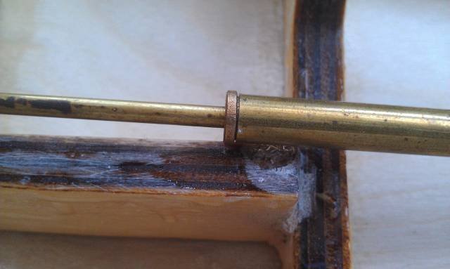

    This is how close the end of the stuffing tube comes to the water channel keels.

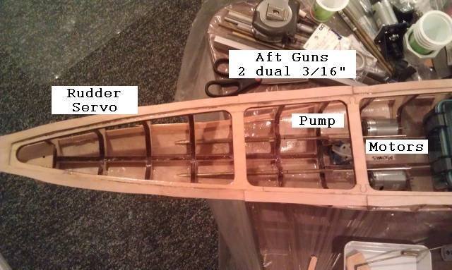

    Stern layout.

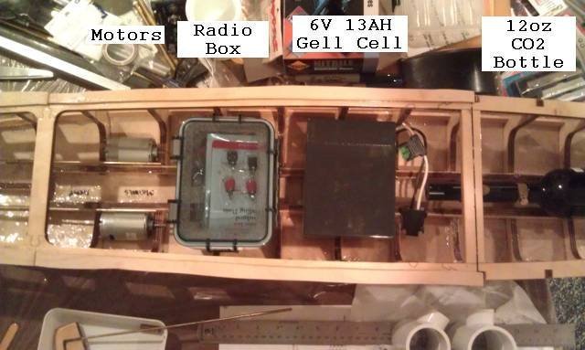

    More internal layout. The LiFePO4 cells will go where the gell cell is sitting. I didn't have the LiFe batteries when this pic was taken.

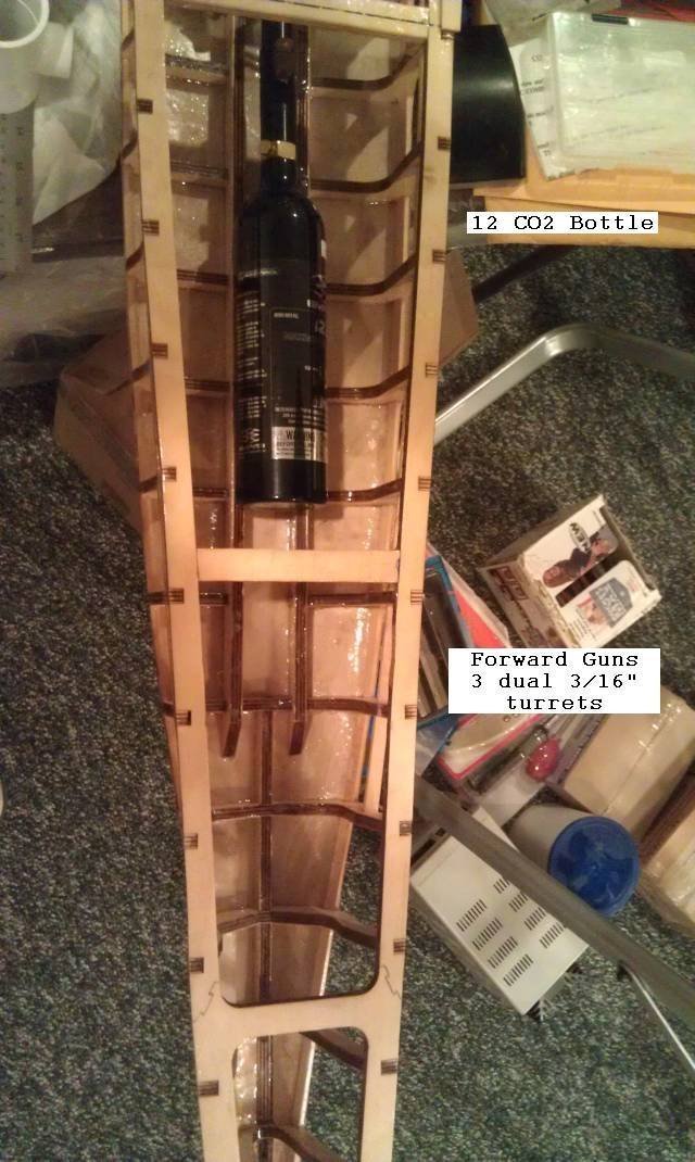

    Placement of 12 oz CO2 bottle and location of forward guns. I was going to put the LiFe batteries on either side of the CO2 bottle, but the spacing is a little tight there. W/o the batteries along side the CO2 bottle, I have enough room to put in a 20oz CO2 bottle!
    As you can see from my internal layout pics, I can't move the motors forward any, let alone far enough to make a simple direct drive work. So I've got to make belt drive units for the motors.
