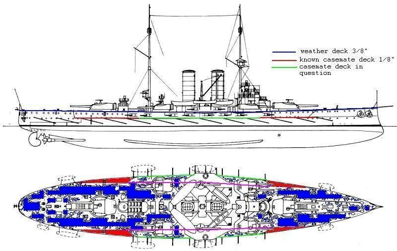

    I would like to bring up my Radetzky then. It is the predecessor of the Viribus Unitas. It has a very similar hull shape to the VU. I am trying to see if I get the 1/8" stringer between the forward and aft casemate steps.
    On the fiberglass hull itself the widest point is near the waterline and it tapers in ever so slightly toward the casemate deck. At the bottom of the casemate it creases ever so slightly and the hull turns straight vertical. On all pictures and scale models I can find there are torpedo nets and it is hard to tell if at that "crease" point if there is the top of an armor belt. In most pictures below the waterline it appears there is one with the top of it undefined. With the wood board that connected the top of torpedo nets it makes it very difficult to see. It is obvious that the areas outboard of the pink lines on the drawing below are for casemates. They just continued the side of the hull up and made it smooth instead of giving it a defined step. The question of the hour for me is, Do I get the stringer to connect the bottom of all those casemate windows? A thing to consider is that if the 1/8" stringer goes immediately under the cupola/ window then there is only 1/8" between that stringer and the caprail. My thought was that I should get the stringer however, I should move it down to create a minimum gap of ??? (3/16"?) between it and the caprail.
    Das Butts[​IMG]
  13. irnuke
    Hi DB,
    An easy way to identify armor belts from photos (and some drawings) is to look for where the portholes stop. Also, on most ships that have visible armor belts, they extend from just aft of the aftermost main gun barbette to just forward of the most forward barbette. The area between these was the critical area, with magazines, engine / boilers, etc.
    All that said, from the best drawings and pics I can find, Rad's belt was continued up between the casements to deck level, giving that smooth line you mention. Since the purpose of the allowed "armor belt stringer" is to allow for a step in the hull, you would not get one in the questioned area.
    What I find ludicrous though (and thank you for illustrating my point so effectively!) is that under the current rules, your deckhouse between the funnels (where the two casement guns are) is also defined as hull and must be penetrable.
    Now, I'm all for having fun and making it fair to everyone, but do any allied drivers honestly feel that they should score points for putting a bb between those two casements? If that's the case, look at the first pics of my Baden refit. Do you think the allied driver that put that hole in the top of my funnel should have gotten credit for that hit too?
    All I'm asking is that the effort to make the rules understandable and fair don't become an ironbound, inflexible dogma that doesn't allow for common sense. Common sense would say that the area between the hull casements on Rad be penetrable, but the 2nd level ones are defined as Superstructure and can be inpenetrable.
  14. Bob
    The 2nd level structure with casement guns on Rad start on the weather deck just behind the A turret well past the 1/2" line. Since it starts above the weather deck it's not part of the hull. Kind of like the Derflinger's casement level or the Strausbergs 1st level of superstructure or the hangers on the US 10k ton cruisers. The I-boats also have casement guns in their super structure. Just having guns that look like casements does not make it hull. Badens casements are under the weather deck at the bow and do not step back 1/2"without returning until closer to the stern. I don't have a print, but it's what people with prints have said. Also the models in our hobby I have seen all had the casements within 1/2" of the edge of the ship.
    I do have a print for the Rad. The casements in the middle are all in the 3/8" hard deck. At least the rounded cupola part is and indent for the gun to swing back and forth. The holes for the casements don't go all the way down to the same level as the bow and aft casement level. There's really no structure there to need a stringer. Now the best photos I have seen are of models and computer renderings. Who knows how good those are. I have not seen a photo of the real ship to tell if there is an armor belt or other bump under the casements. If I was building one I would not put in the middle casements or the stringer.
