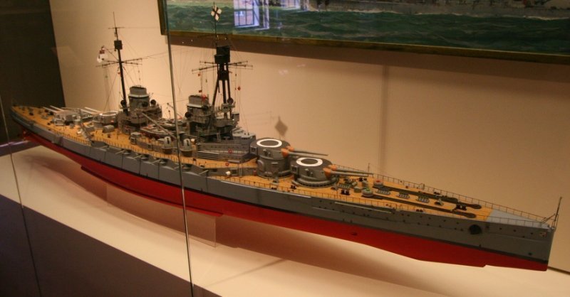

    http://savepic.net/863447.htm
    You mean the two directly in the bow? Rotsa ruck finding even one. Your hypothetical is a bit weak, in that if you could find such a pic, that would mean there actually was some sort of deck there. If there was some sort of deck there, then yes, inboard of it would be superstructure. Have you heard the hypothetical "If my aunt had gonads, she'd be my uncle"?
    For Bayern class, an outboard deck extends forward of Anton turret, is planked and railed, and has a vertical ladder leading to the forecastle deck.
    http://www.flickr.com/photos/yetdark/3831461538/lightbox/

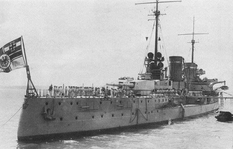

    Fine - Lets look at the stern casemate deck on the VDT - not the most extreme casemates that lack a deck, but the ones where the hull clearly juts inwards and has a deck. I know part of this is > 1/2" inboard, but since you're proposing to do away with that, lets focus purely on whether this is deck or not and if what is above it is then superstructure.
    I found a picture with railings.
    Look, I agree with you that the rules are wonky, and I personally don't agree with them, and I approve of your attempt to find a set of rules that would be a little more logical and less 'magic numbery'. I personally think all casemate areas should be solid and points based on sinks should be counted and not holes, but thats my problem. What I do find a little bizarre though is that your litmus test would declare this section on the VDT to be superstructure. You're going to need to work on the wording very carefully or the criteria if you want to get the masses on board with this.
    Also, in your qualifications of a deck, do grab irons for access count as a permanent ladder? Because I see sets leading down to those aftmost casemates and their tiny little 'decks'...
